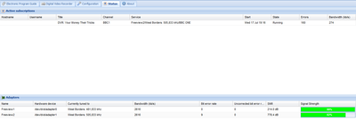

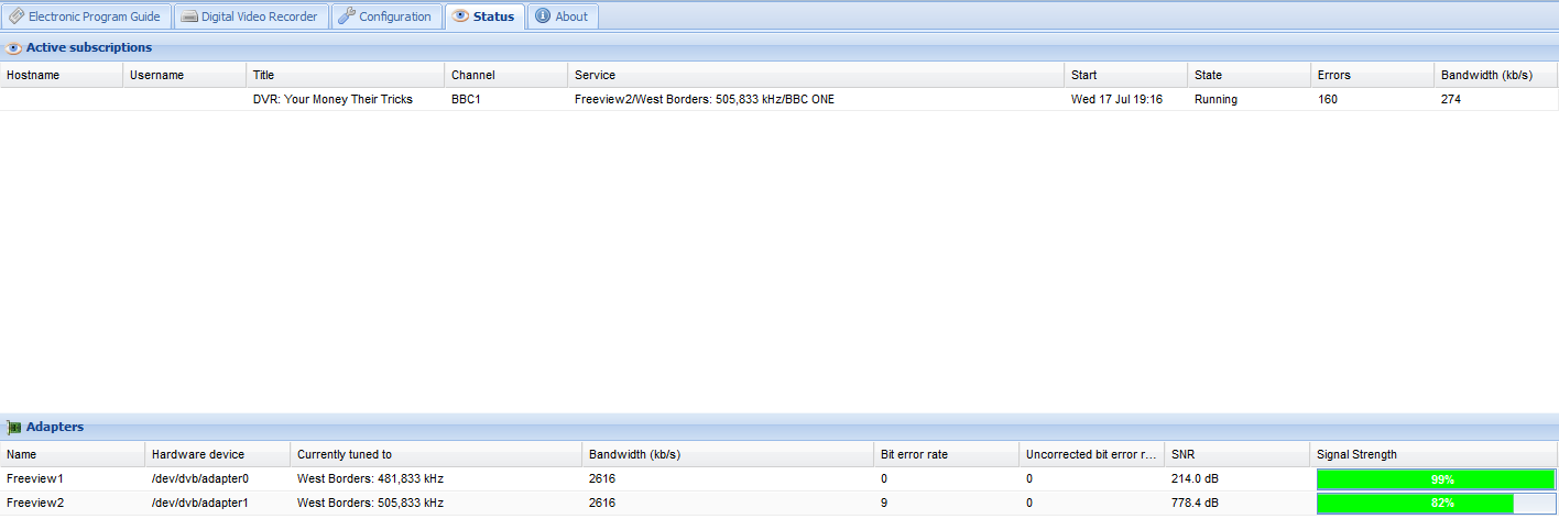

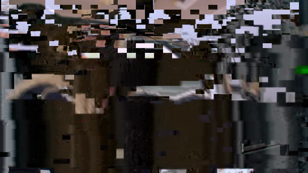

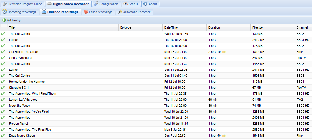

I have attached sample images to illustrate. One is what the video looks like when I try to watch it, one is the tvheadend screen during recording - note the errors at the right hand side, and one is the file list after the recordings have finished - note the filesizes as the corrupted ones are considerably smaller than the uncorrupted ones.
