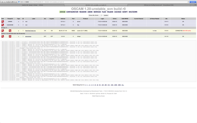

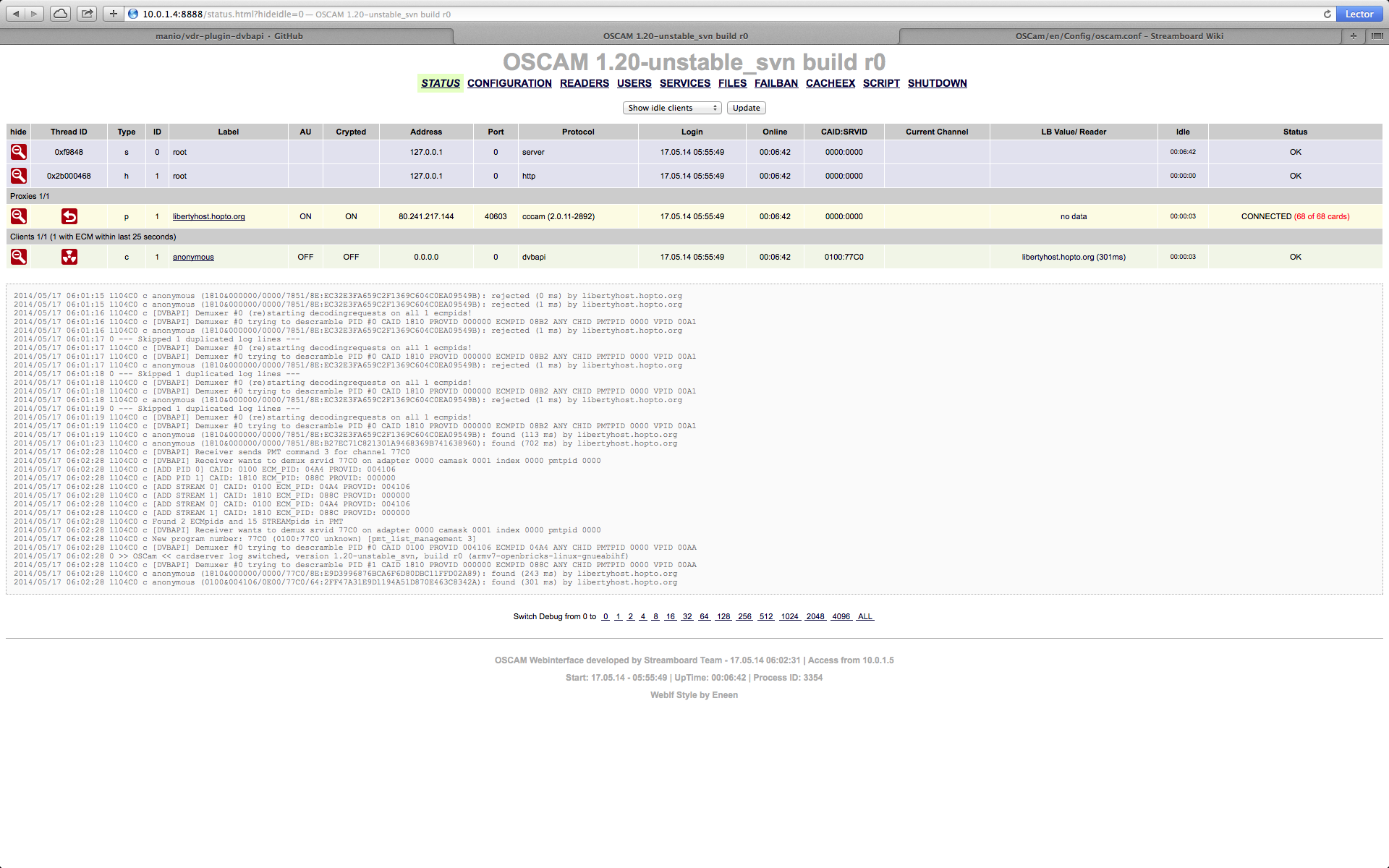

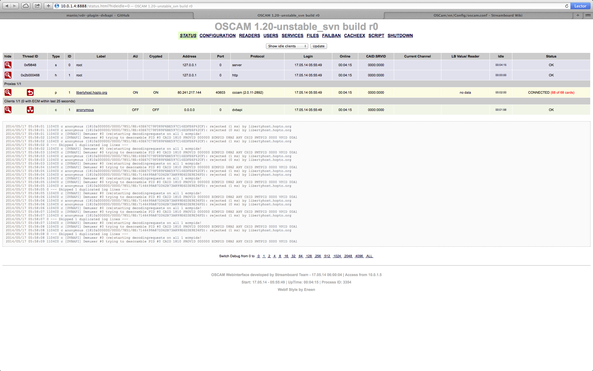

Postby luistobcn » Sat May 17, 2014 7:11 pm
Hi.
I see in status oscam dvbapi is ok,but Au and crypted is OFF 1-picture
VDR connect with oscam .When I put an encrypted channel 2-picture
There is on screen a message channel encrypted,not play
any help is welcome
