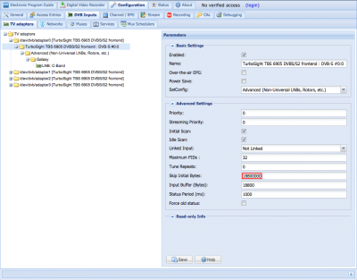

Postby cband » Tue Jul 28, 2015 3:49 am
For anyone else experiencing this issue, I'm now testing the following fix in TVHeadEnd, setting a "Skip Initial Bytes" value for each TBS 6905 tuner. Don't know yet if it's the ultimate solution, but might be worth a try (see attached image file). The 18800000 setting is a bit arbitrary; I chose it because it is more than 1 Meg and is the "Input Buffer (Bytes)" value x 1000. If the issue persists I may try an even higher value.
If the new value doesn't appear after you change it and click save, refresh the page in your browser, then navigate back to the TV adapters tab.
Thanks to Cody for his help with this!
