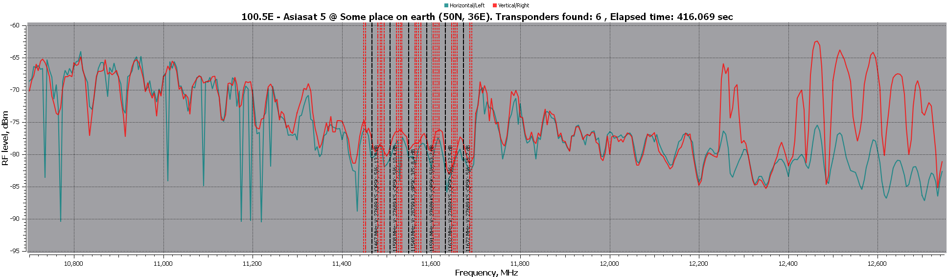

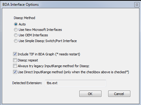

Failure Details: Diseqc 1.1 is automatically switching to Port 1 while starting Blind Scan. Attaching the screenshot where you can see RF scan found frequencies at Vertical polarity after 11700 whereas Blind scan is finding before 11700. I am also attaching DVB Dream Device options settings since DVB Dream is working fine no matter in what order I am switching the LNBs.

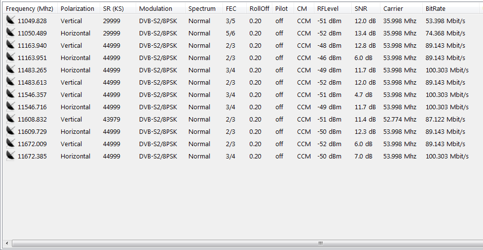

Blind scan details from ST 2 88 E satellite showing all parameters.
As you can see the bitrate of 11050 V and H are lesser comparing other TPs and I am also not facing any problems in these two TPs.
11609 V is the 3rd lowest bitrate (87.122) TP and in that I am having less packet loss.
There are 5 other TPs having 4th lowest bitrate (89.143) and there are more packet losses. Getting pixels alone instead of video that too only sometimes.
There are 4 more TPs (11483 H, 11546 H, 11546 V, 11673 H) having more than 100 Mbit/s bitrate. Most of the time, channels are not getting scanned in at least one of these 4 TPs for sure. Even if scanned, it will have huge packet loss and no picture at all will be there.

for tbs5990, it's Bridge chip can support the maximum to only 90Mbit/s. if SNR low to 10 dB ,I think it is not a good signal.

So, it will not support anything more than 90Mbit/s !!
In ST2 satellite, only 4 TPs are having 100 Mbit/s and rest 8 TPs are lesser than 90 Mbit/s. But still those TPs are not working properly.
Among those 8 TPs, only 2 are having lesser signal (less than 10 dB). So, what about the remaining 6 TPs? Those TPs are also not working in TBS 5990.
I am listing out those 6 TPs for easy reference. So, TBS 5990 will never support these signals? Not possible to fix this in upcoming days?
11050 V 29999 DVB-S2/8PSK 3/5 SNR:12.0 dB 53.398 Mbit/s - Working fine
11050 H 29999 DVB-S2/8PSK 5/6 SNR:13.4 dB 74.368 Mbit/s - Working fine
11163 V 49999 DVB-S2/8PSK 2/3 SNR:12.8 dB 89.143 Mbit/s - Not working
11483 V 49999 DVB-S2/8PSK 2/3 SNR:12.0 dB 89.143 Mbit/s - Not working
11608 V 43979 DVB-S2/8PSK 2/3 SNR:11.4 dB 87.122 Mbit/s - Not working
11609 H 49999 DVB-S2/8PSK 2/3 SNR:12.3 dB 89.143 Mbit/s - Not working
The below TPs having lesser thatn 10 dB signal are working fine in STB and it is showing 67% signal strength. But still I will try to get more singal on those TPs.
11163 H 49999 DVB-S2/8PSK 2/3 SNR:6.8 dB 89.143 Mbit/s
11672 V 49999 DVB-S2/8PSK 2/3 SNR:6.8 dB 89.143 Mbit/s
Only the below TPs are having more than 90 Mbit/s
11483 H 49999 DVB-S2/8PSK 3/4 SNR:11.7 dB 100.303 Mbit/s
11546 V 49999 DVB-S2/8PSK 3/4 SNR:4.7 dB 100.303 Mbit/s
11546 H 49999 DVB-S2/8PSK 3/4 SNR:11.7 dB 100.303 Mbit/s
11672 H 49999 DVB-S2/8PSK 3/4 SNR:7.0 dB 100.303 Mbit/s
Thanks,
Sadiq

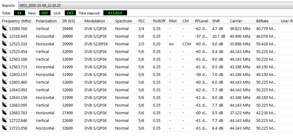

Also, another satellite at 91.5 which is having lesser than 10dB are working fine. They are also DVB S2 8PSK but on Higher band with lesser S/R (36MHz TPs). Screenshot below.

Postby luchy » Tue Oct 11, 2016 10:06 am
The above not working TPS are very near its maximum linit speed 90Mbit/s, I think that's why they are lost package.
