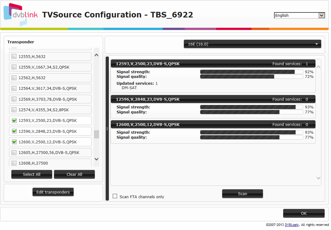

Postby lujo » Sat Nov 23, 2013 12:27 am
I am using TBS6922 with the newest 1.0.1.5 driver (with the previous driver 1.0.1.4 I had the same problem)
Dish is Triax 78cm with Moteck-1200A

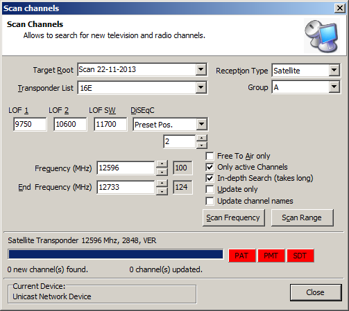

Software that I have tried: DVBViewer and DVBLink TVSource
With both software I cannot scan some frequency on 16.0E satellite.
Frequency that I CAN scan:
DM Sat - 16.0E 12593 V 2500 2/3
Frequency that I CANNOT scan:
RTV Montenegro - 16.0E 12596.94 V 2848 2/3
Atlas TV (Montenegro) - 16.0E 12600.75 V 2500 1/2
I think this is strange because all above channels are on the same transponder and "DM Sat" I can scan but "RTV Montenegro" and "Atlas TV (Montenegro)" is not possible.
Is this problem of TBS 6922 or driver or something else?
P.S See attachments
DVBLink TVSource
DVBViewer

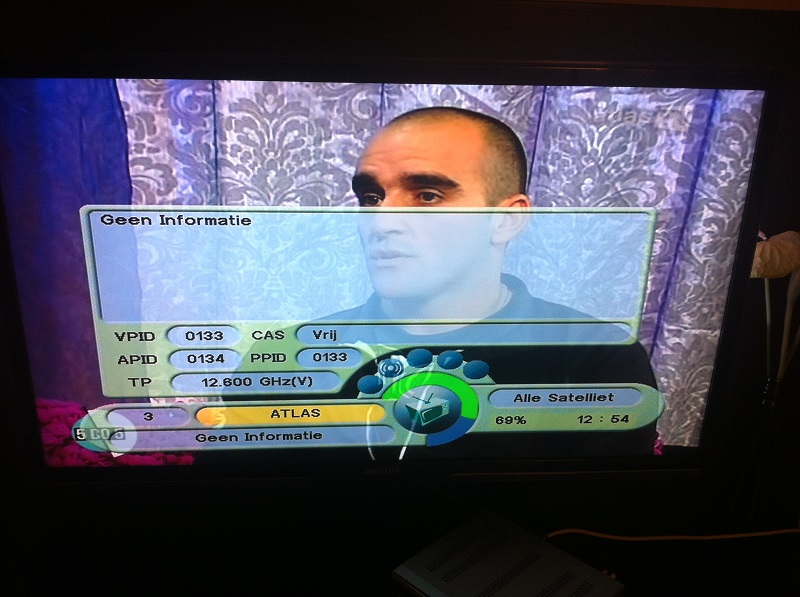

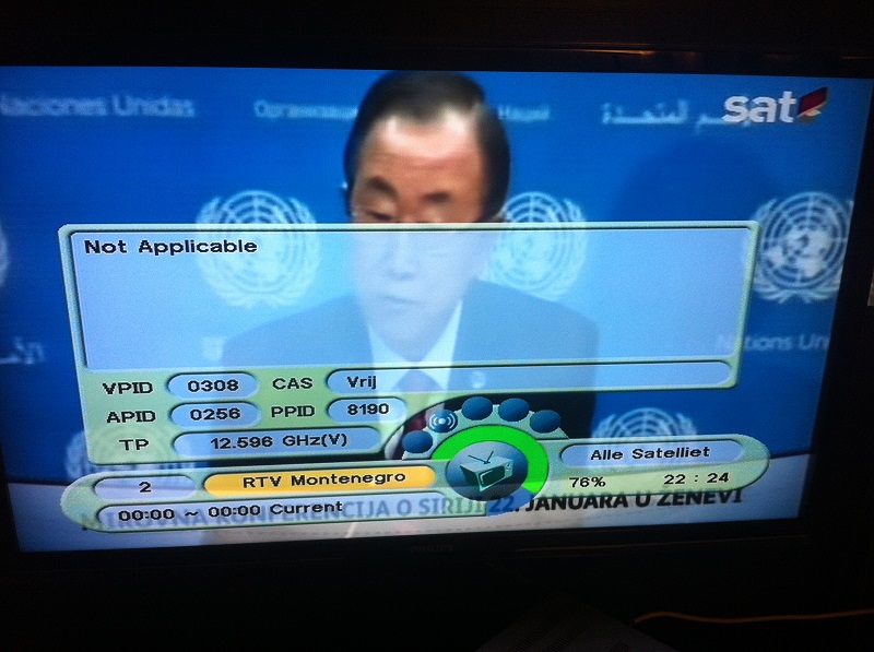

cody Wrote:Hi, at this point nothing can be said for certain what is the root cause of the problem. have you tried and confirmed you can receive those transponders with other DVB-S/S2 hardware like set-top-box? it could be there is problem with your signal and it's very weak.
Cody, sorry but don't you think it is strange to say that there could be problem with my signal when I am able to receive (16.0E 12593 V 2500 2/3) which is on the same transponder (F04) as (16.0E 12596.94 V 2848 2/3) and (16.0E 12600.75 V 2500 1/2) which I cannot receive.
http://nl.kingofsat.net/tp.php?tp=850
But just to be sure I have used my very old receiver (from 2006) and with this very old receiver I am able to receive those channels.
RTV Montenegro:
Atlas TV (Montenegro):

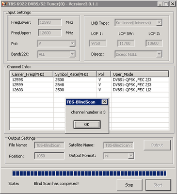

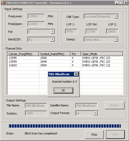

I have tried TBS Blind Scan V3.0.1.1. tool to see if I can get any results.
This tool gives me those results:

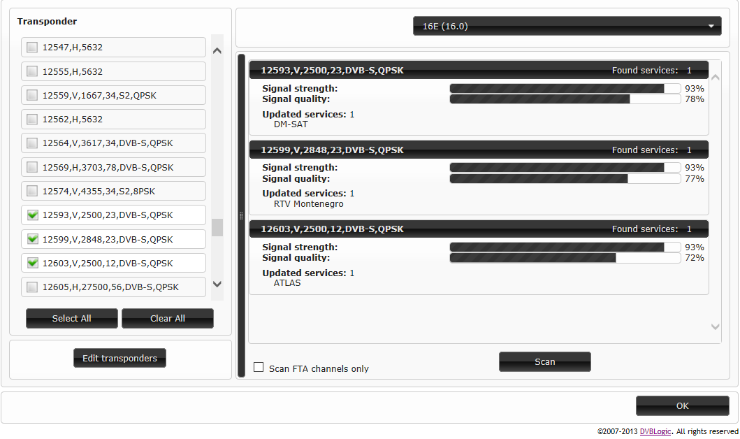

After this I have changed frequency in TVSource application from 12596 to 12599 and 12600 to 12603 with those results:
What is the reason for those deviations?

i replied to you in an email, but just for completeness and to help other users to copy it here and even explain in short - the frequency offset you get is probably due to bad LNB:
On 27.11.2013 г. 09:40, Turbosight Europe wrote:
> hi Lujo,
> the card has auto-frequency-acquisition - that's hardware feature, but you can control it in the driver - within what range to try to fine tune the frequency. so, let me give you an example - if auto-frequency-acquisition is set to 5MHz and you tune transponder with frequency X, then all frequencies between [X-5, X+5] are tried by the hardware in order to find the best one - that's to compensate for any frequency offset, because faulty or low-quality LNB can add error and shift the frequency with few MHz.
> best regards,
> constantine
