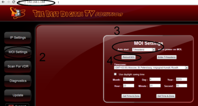

Postby ahmedramze » Thu Dec 05, 2013 5:38 am
Hello
after upgrade you need to select whcih service to start , TVHeadend or VDR the defulat setting its off for both , login using MOI ip for ex http://192.168.1.188 with out any port
then go to MOI setting then select the main service and reboot it , like picture below
MOI
after that you can login using http://192.168.1.188:9981/
ahmedramze
