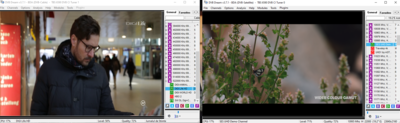

I hope it's not bad luck in choosing tbs6590 card,because both tuners work fine,regardless of whether you choose to see a satellite tv program and one on cable or terrestrial at the same time.Or you can simultaneously watch two tv programs from two satellites without any problem.But for this,as you may know,you need to initialize both tuners with the help of TBS6590ChangeToolMode utility.
Besides the fact that this card has two tuners that you can use simultaneously,it is also equipped with the S2X extension for receiving frequencies transmitted in this mode.
If you want,you can read a review about this card,here.
