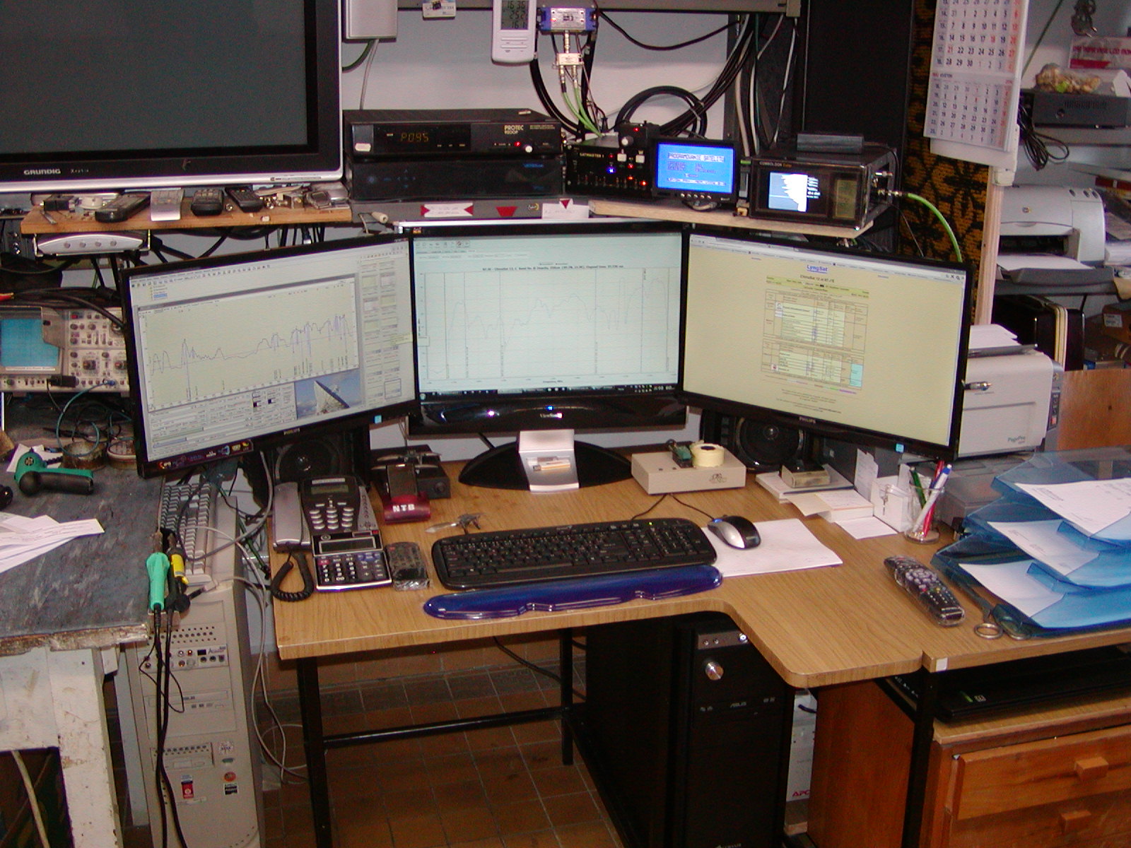

Peon`s workshop

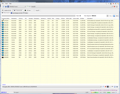

- Blind Scan is as good as in the top model 6903, but very slow right now. We believe that Crazy Cat`s Stream Reader or new drivers can improve that.

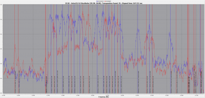

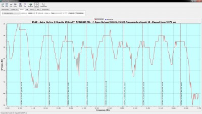

- Great frequency accuracy. Frequencies are very close to those listed on http://en.kingofsat.net/satellites.php (2 decimal places: 11178.50) or by NIT and this card is beaten only by TBS 5925! Even 6983/6903 are worse. Used Lnb : NJR 2842S.

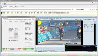

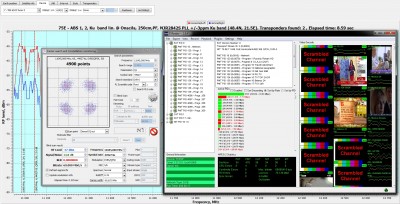

- Flawless reception of 16APSK

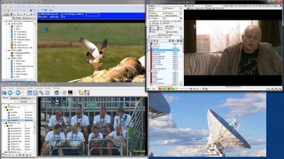

TBS 6522 (DVB-T+DVB-S) and TBS 6903 reception

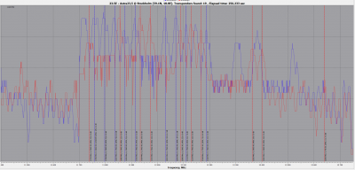

TBS 6522 - SR 468

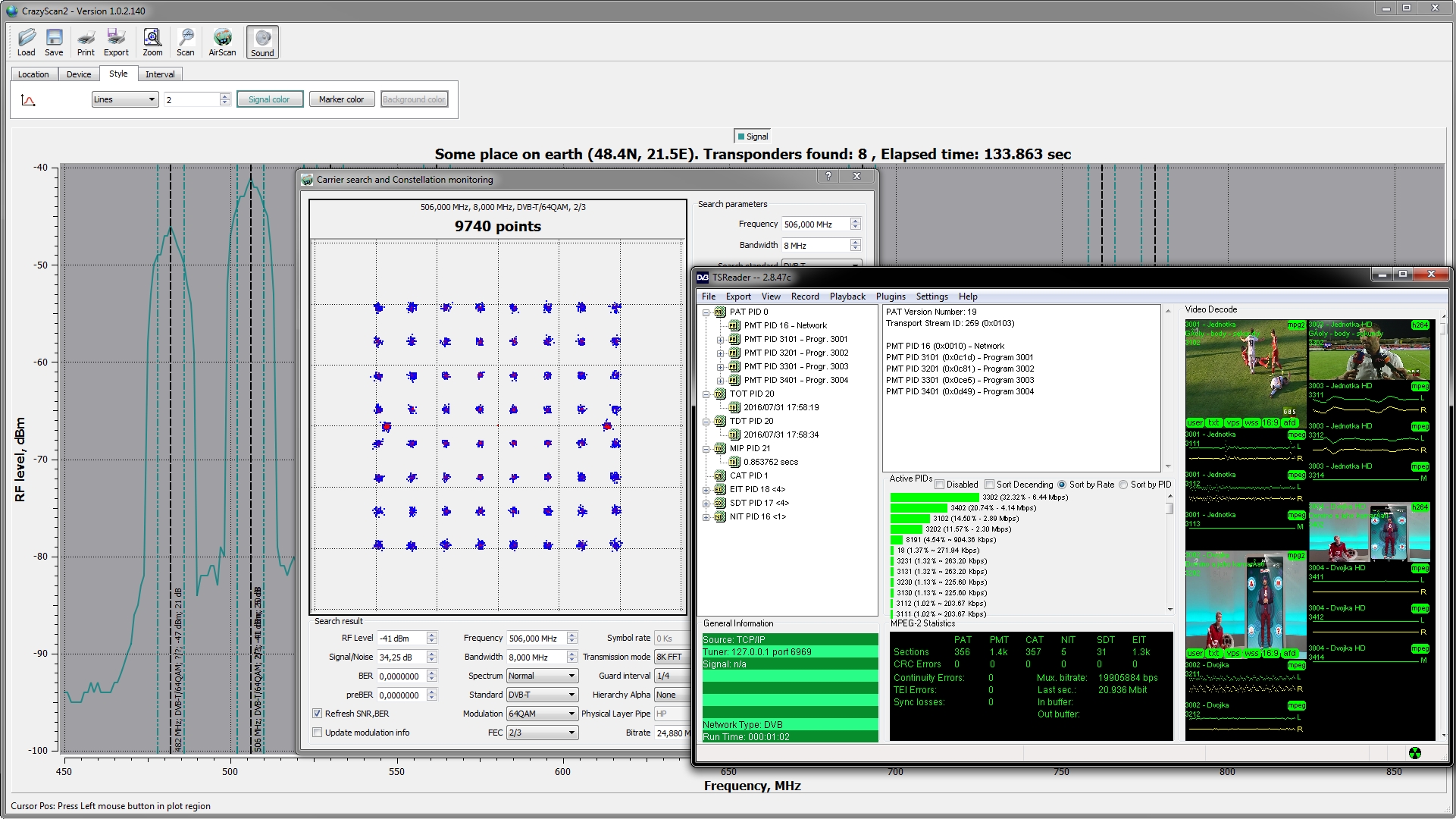

TBS 6522 Terrestrial reception

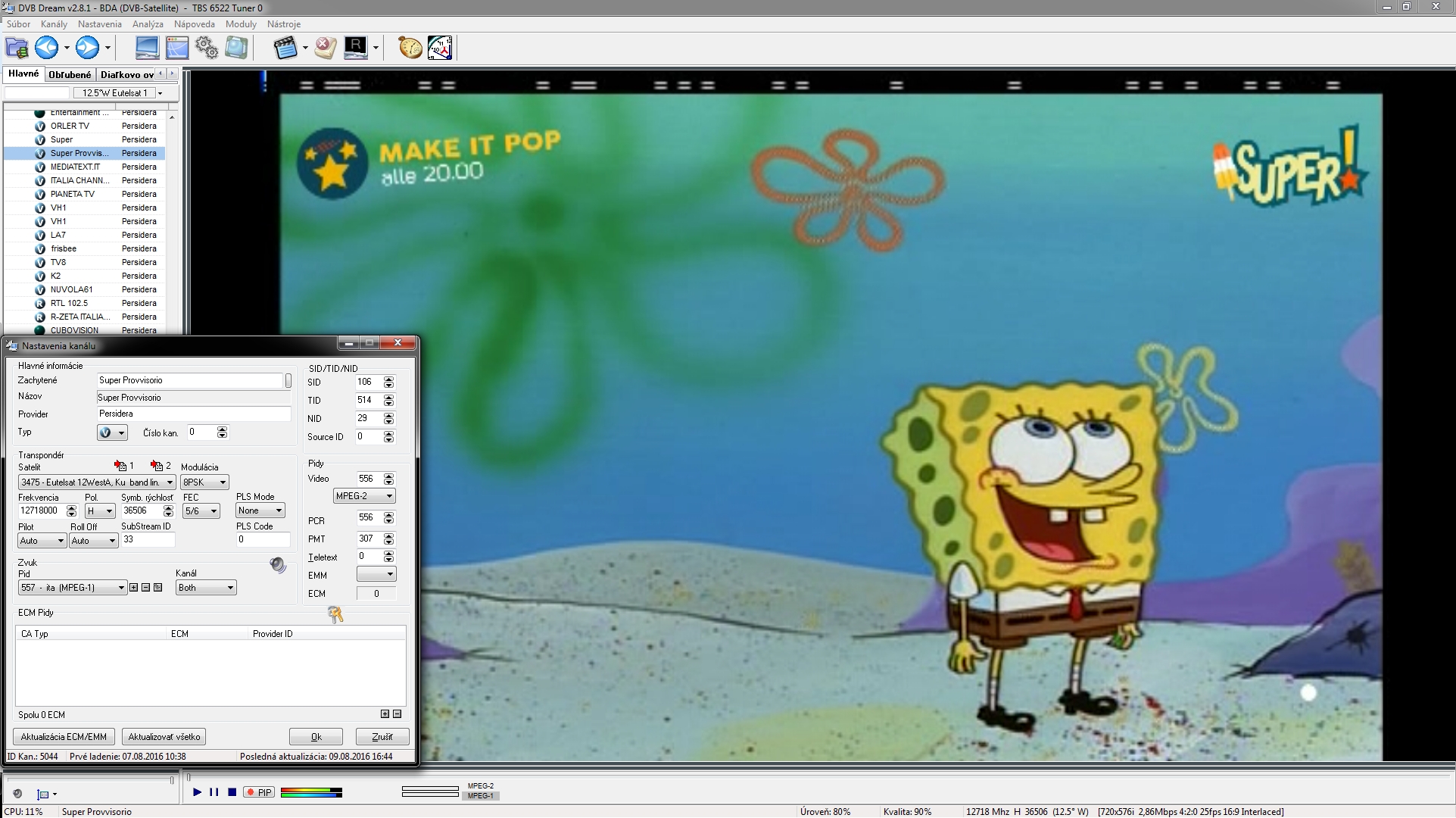

TBS 6522 Multistream reception

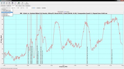

TBS 6522 - Frequency accuracy

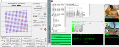

TBS 6522 - DVB-S2 16APSK reception

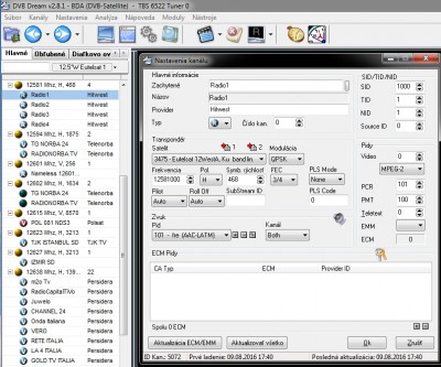

TBS6522 75.0e Ku SR 44927
Device list - no hardware/drivers issues

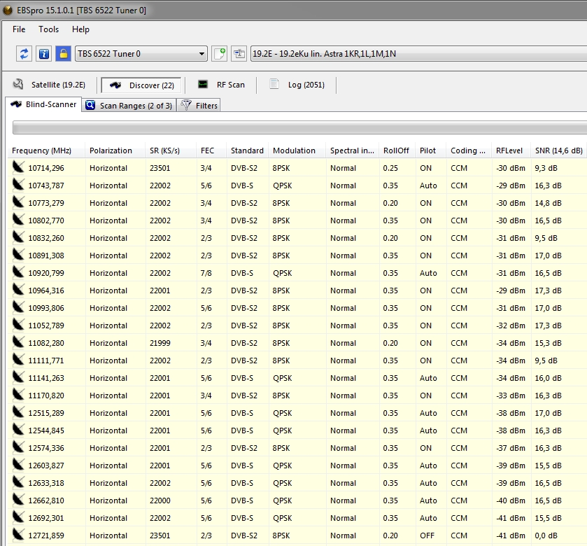

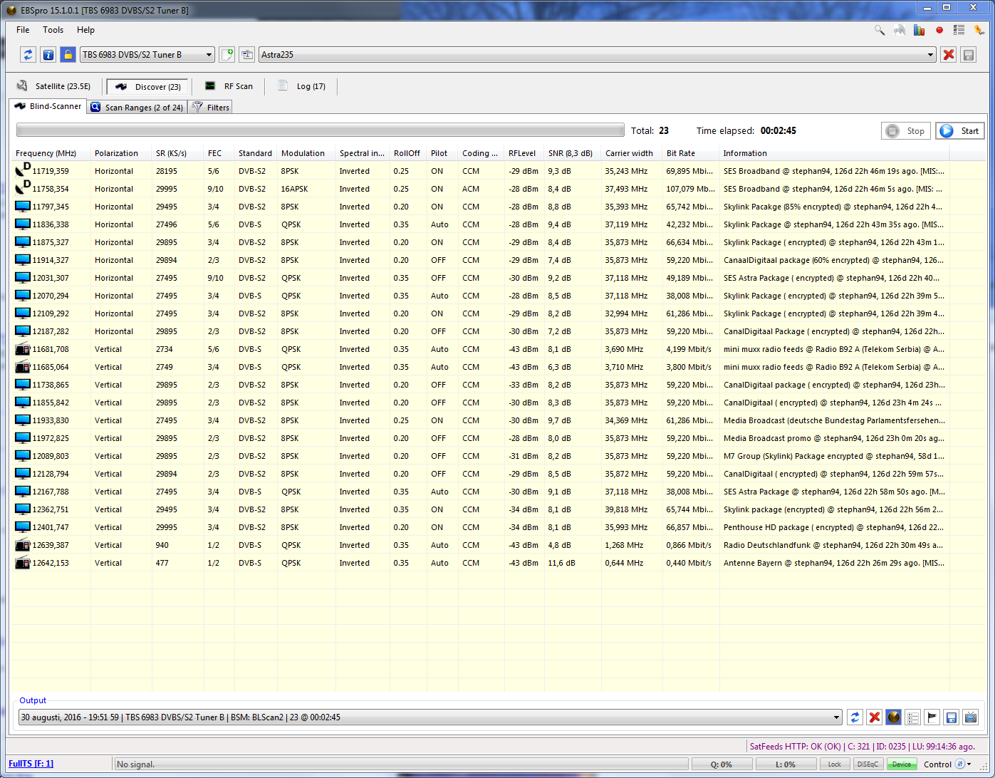

Postby angelsevov » Wed Aug 31, 2016 7:01 pm
hi guys,
i have TBS6983 and TBS6522 and tbs6220 installed on my MacPro (Windows 7x64)
i just started to test the TBS6522 and the first thing
that i saw TBS6983-tuners high sensitivity (or it is a driver issue and TBS6522 needs better driver) Strange thing with SNR levels. Check screenshots. EBSpro have a little bit problem with TBS6522…
what i’ve done….
Installed TBS6522 driver 1.0.0.2 from TBS
TBS6522 DVB-S/S2 on DVBViewer and DVB Dream doesnt work and channel scan gives 0 channel(s)
[they do see the transponder and LOCK is ok but scan gives me 0 channels. Signal quality 80/90]
update: i uninstalled SDRplay drivers (it uses BDA-interface, can it be the cause of this strange problem?). And now it works. founds channels. Transedit works too.
TBS6522 DVB-T/T2 function: no luck… it sees the signal but scan gives 0 channels. on Both DVB-T and DVB-T2. Tried with DVBviewer and DVB Dream and Transedit.
(PS: tbs6220 works perfect under all applications with this driver “TBS6220 DVB-T2/T Windows Driver V1.0.1.2” all those (DVBViewer, DVB Dream and Transedit) sees that there is a DVB-T2 tuner in present. installing “TBS6220 DVB-T2/T/C Combined Driver V1.0.1.2.” brokes functionality. LOCK is ok, no channels under DVBViewer, DVB Dream and Transedit.
Uninstalled all drivers (tbs6983,tbs6522 and TBS6220). Removed TBS6220 from computer.
Left tbs6983 and tbs6522.. Installing first driver for tbs6522 and left tbs6983 without driver. Trying tbs6522 DVB-S/S2.. Oups now it is broken again. Same problem [there is transponder and LOCK is ok but scan gives me 0 channels. Signal quality 80/90]
No luck with DVB-T/T2 function (what is the problem :S).
Installing tbs6983. Nothing changed.
tbs6983 worked/works perfect under all circumstances.
Am i missing something?
TBS6983 and EBSpro
TBS6522 and EBSpro
TBS6983 and crazyscan
TBS6522 and crazyscan

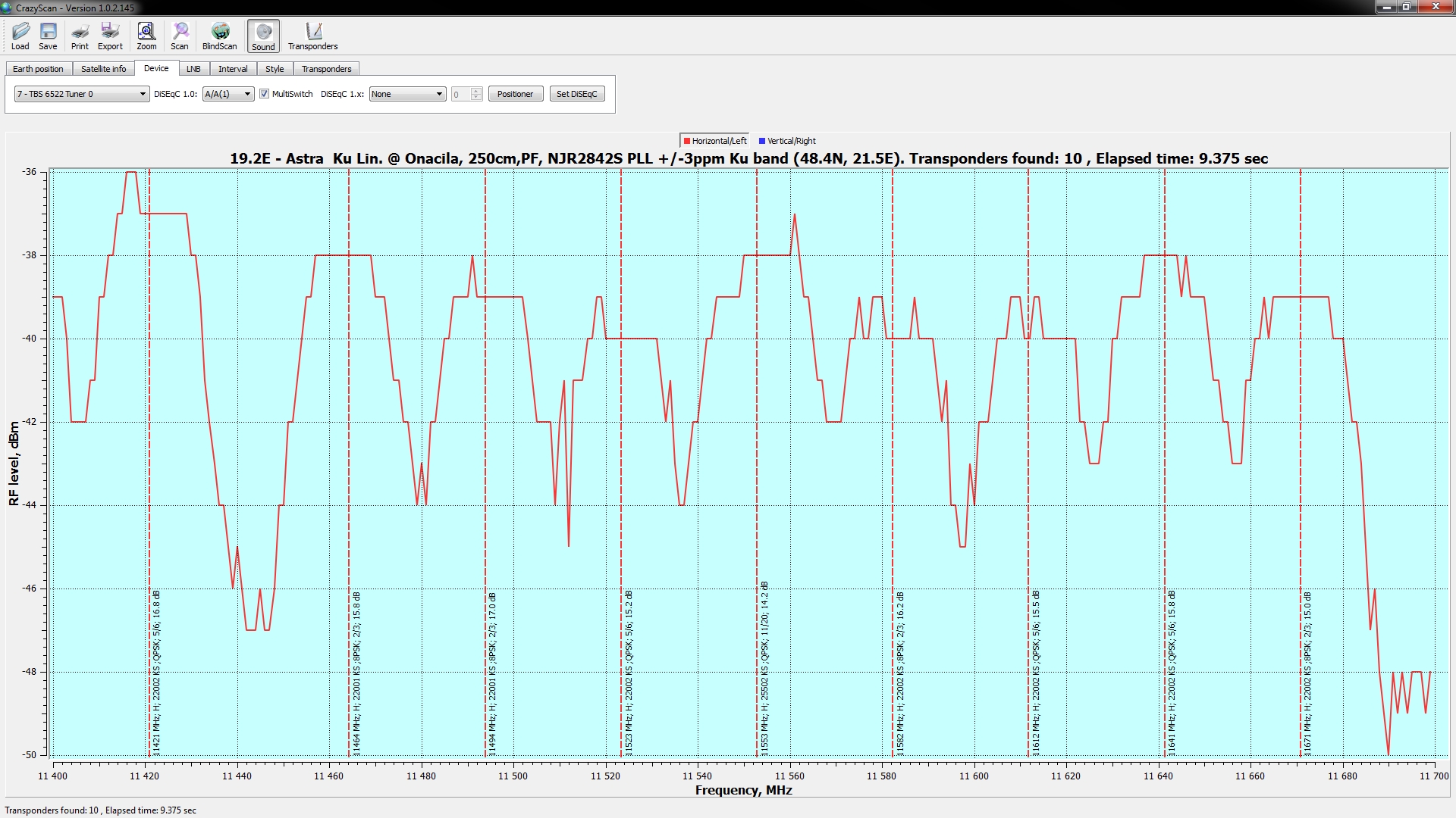

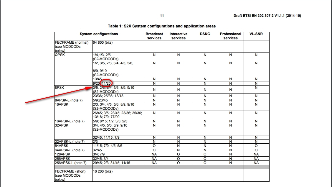

Postby sato » Mon Oct 03, 2016 4:14 am

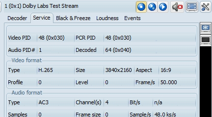

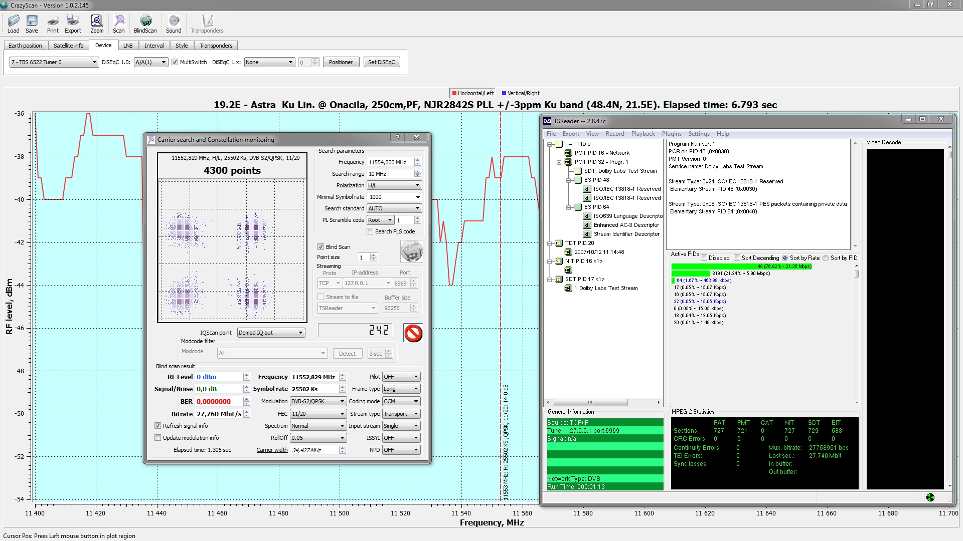

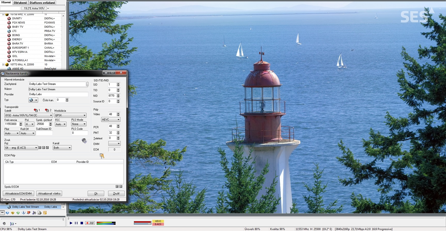

First DVB-S2X reception report by Peon (Onacila).
Astra @ 19.2E, frequency 11552, SR 25502, FEC 11/20
Scan of Astra 19.2E (2 October 2016) by TBS 6522
DVB-S2X found on Astra 19.2E
Picture and sound provided by TBS 6522 (DVB-S2X)
DVB-S2X provider info (4T2 analyzer)
DVB-S2X information table
