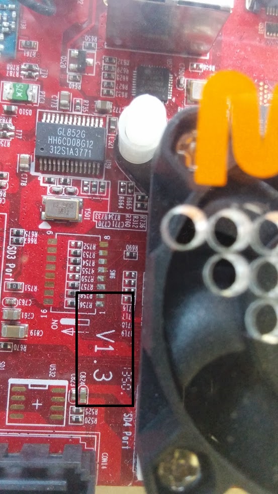

Postby buddyrm » Fri Nov 11, 2016 9:57 pm
Vpeter, this version still does not work for video playback. But I noticed that this is version 1.3 and NOT 1.2 or 2.1. Would that be the issue? See attachement

Postby vpeter » Fri Nov 11, 2016 10:00 pm
I see no reason why v1.3 would not work if older and newer revision works. It would be nice to get some manufacturer support but this would probably be too much :lol:
Maybe your hw is just broken? ;)

Re: LibreELEC (Krypton) v7.90.008
Postby buddyrm » Fri Nov 11, 2016 10:13 pm
I can not see how it is broken. the old install works and I have been using it for over a year. It's just when playing video, the unit start playing but I only get the play bar on the bottom and a few seconds later it crashes. Definitely a video driver issue with the V1.3. :-(

Postby buddyrm » Fri Nov 11, 2016 10:33 pm
Thank I will follow it up. Just a quick note. This version 1.3 has the video GPU Vivante GC2000. What does the 1.2 and 2.1 have?
Postby vpeter » Fri Nov 11, 2016 10:38 pm
buddyrm wrote:Just a quick note. This version 1.3 has the video GPU Vivante GC2000. What does the 1.2 and 2.1 have?
I would assume both have GC2000 because they are based on i.MX6 Dual/Quad. Just like Udoo system and solidrun's cuboxi on which this image works fine.
Only i.MX6 Solo/Dual Lite has GC880. And I doubt tbs would use first one type of soc, then another and later switched back.
