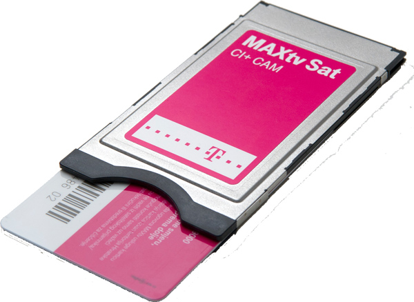

thanks for the quick answer. Here the module Info:
CAM Application type: 01
CAM Application manufacturer: 0000
CAM Manufacturer code: 0000
CAM Menu string: MAXtv Sat CI+ CAM
CAM supports the following ca system ids:
0x1830
0x1811
Module info:
0. Quit menu
1. Product Name: MAXtv Sat CI+ CAM
2. Brand Name: SMARDTV
3. Part Number: CI0355-CTR01
http://en.kingofsat.net/pack-maxtv.php (so they are 65Mbps)
