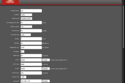

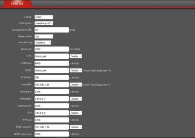

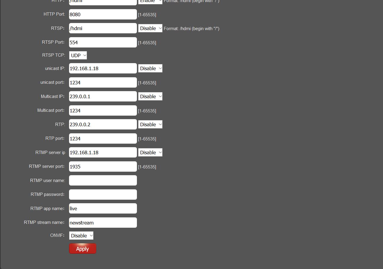

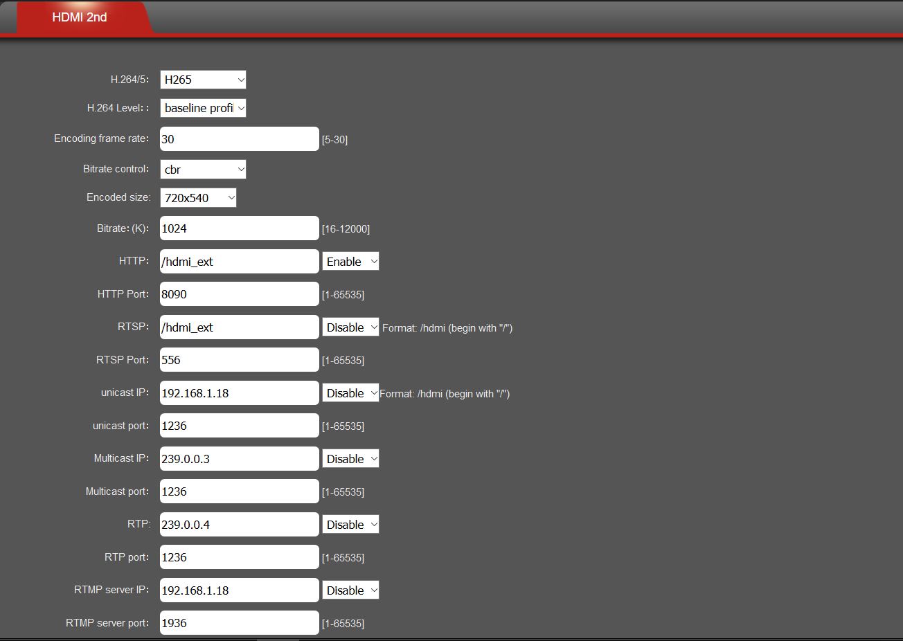

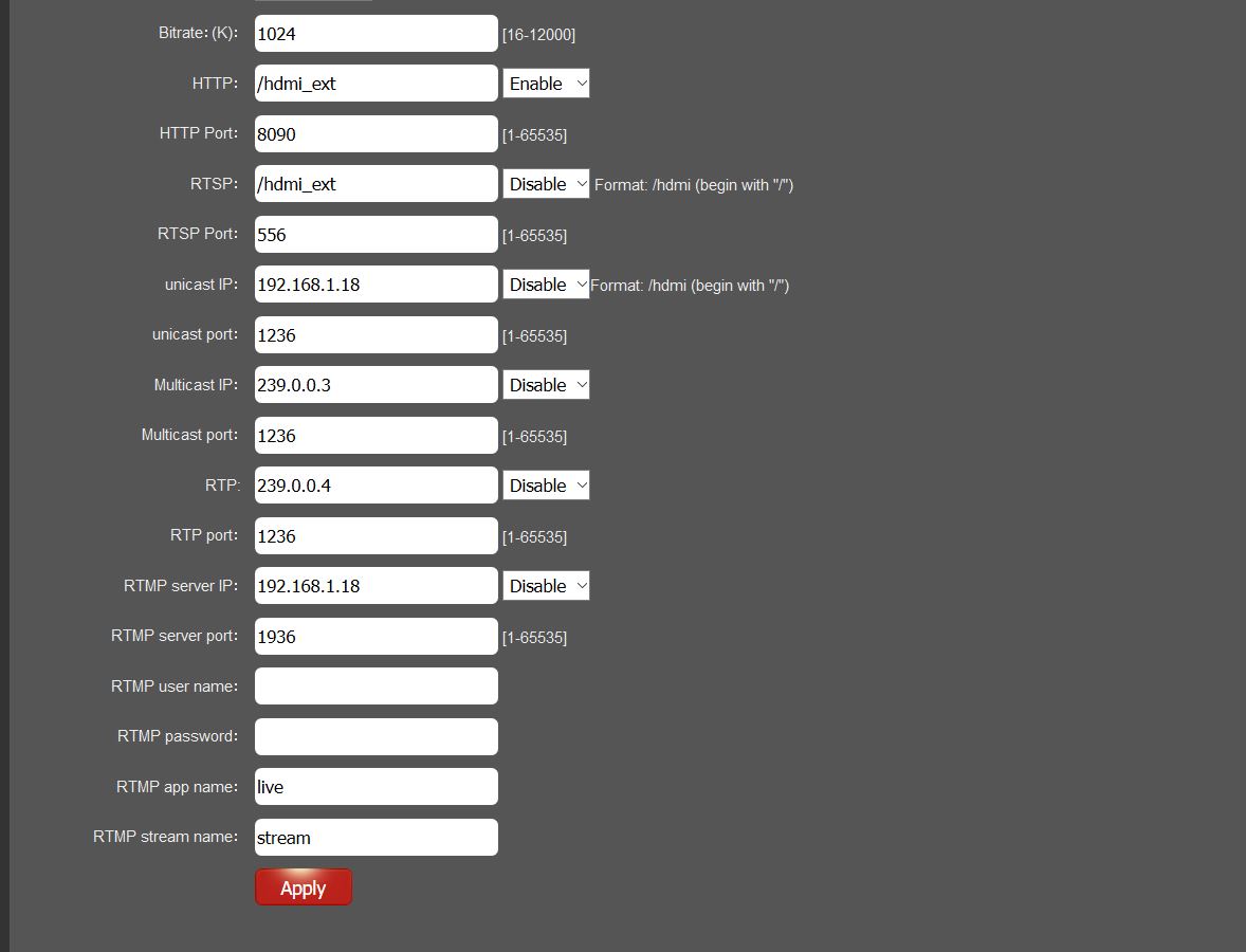

Hi Sergio, thanks for your help. Standard settings, please see the pics attached. When I open the first stream with VLC it works fine, but with the address of the second stream I get the following message:
Your input can't be opened:
VLC is unable to open the MRL 'http://192.168.1.168:8090/hdmi_ext'. Check the log for details.
2nd stream, bottom screen
2nd stream, upper screen
Main stream, bottom screen
Main stream, upper screen

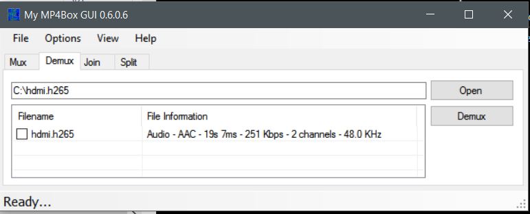

I just observed after opening the second stream url with Firefox that a stream is being produced by the second engine, but analysis of the stream contents shows that it only contains AAC audio, see the picture attached. This is why I cannot watch it with VLC: the stream is lacking video content.
