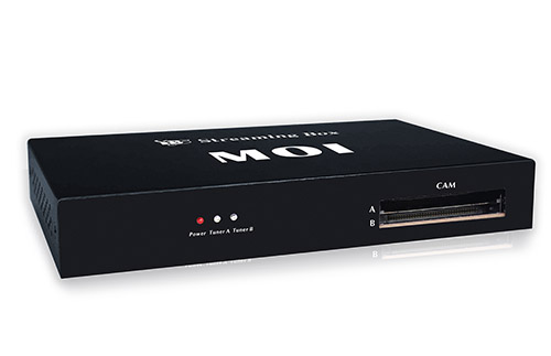

• power off MOI, insert the micro SD card to the "Micro SD" slot at the back of the MOI box.
• power on MOI, the upgrade will start automatically and the LED light "Tuner A" at the front stays flashing until the upgrade is complete, then power off MOI disconnecting the mains, take the micro SD card out and reboot MOI to finish the whole procedure.

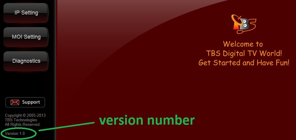

2) Update through WUI (Web User Interface)
Open WUI by entering the default IP adress192.168.1.188 (or your own MOI IP address after you've changed it) in the browser, go to "Update", select and upload the files to proceed with the update. Note: this method applies only to MOI with firmware version 1.2 or later; for MOI with firmware version 1.0 and 1.1, update through a micro SD card is the only method.
