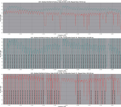

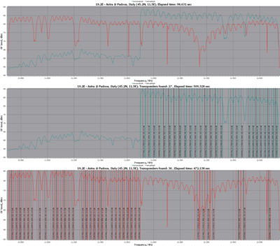

Hello everybody,
I recently discovered that my TBS5922 does not properly tune all available transponders.
From attached CrazyScan 1.0.1.96 reports, you can see that:
1. 13.E Hot Bird: many transponders are missing for high band - vertical polarity;
2. 19.2E Astra: same thing, missing transponders for high band - vertical polarity;
3. 19.2E Astra: signal level for low band - horizontal polarity is extremely low.
About points 1-2, it is not just CrazyScan: DVBViewer 5.2.0.0 does not tune any channel
on the missing transponders too.

CrazyScan report for 19.2E Astra (DiSEqC B)
CrazyScan report for 13.0E Hot Bird (DiSEqC A)
