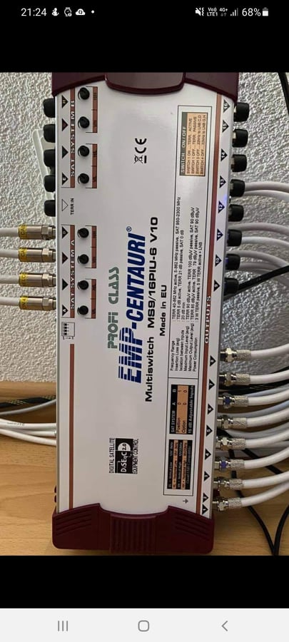

I use two TBS cards, the first TBS6909 works fine but the second TBS 6909x v2 card not work good.
I have the satellite system connected like this from quad-lnb to the EMP MS9 / 16PIU-6 multiswitch and from there I have it connected to all tuners. as I wrote TBS 6909 works well, but TBS 6909x v2 does not work well in mode 0, I need to use all tuners separately but in mode = 0 TBS6909x v2 does not tune all frequencies, in mode = 1 tunes only 2 / 4tuners, other tuners do not tune anything.
why don't all tuners on TBS6909x v2 tune me in?
it s my multiswitch .
