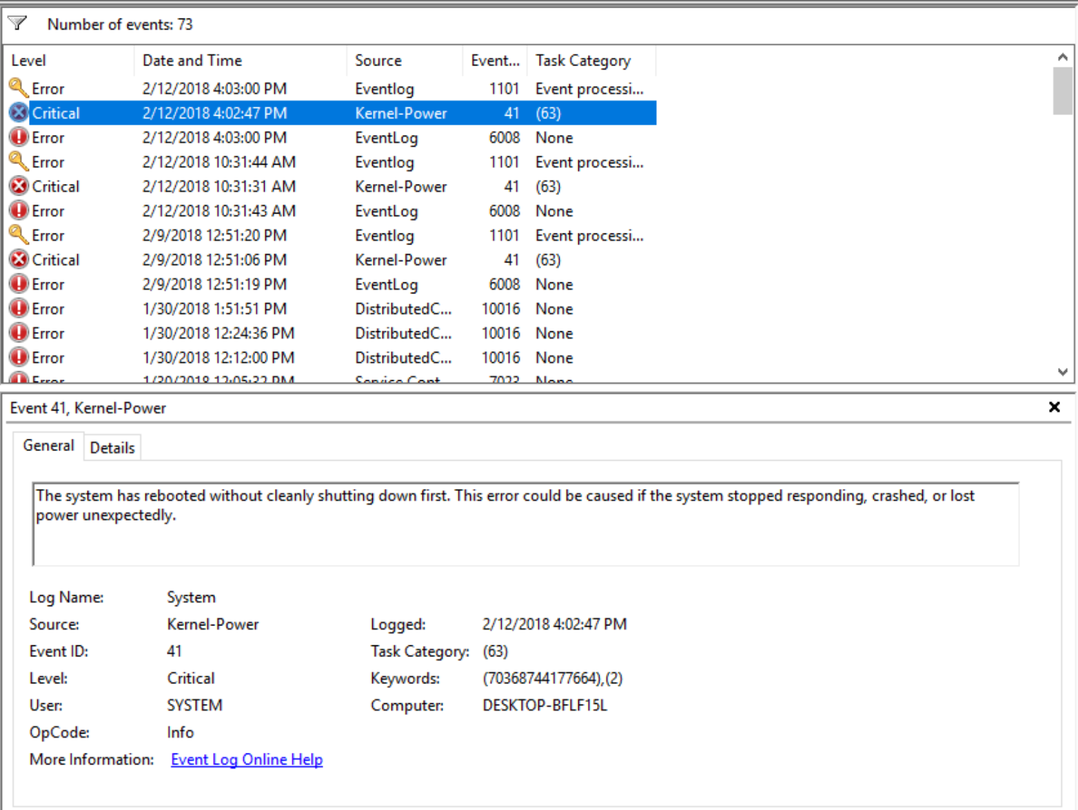

Postby phkarmur » Tue Feb 13, 2018 12:12 am

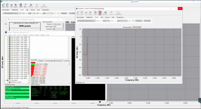

I have teamviewer access of a windows 10 machine with 4 TBS 6908 cards connected, now if I start 2 BlindScan from one card at that time machine goes offline/crashes.
But if I start 4 blindscan from different cards then it works fine!
What issue can be? and please help me to fix this issue
OS: Windows 10 Pro
StreanReader: Ver:1.2.3.1382-commited (Jul 30 2016, 01:48:00)
Driver: 1.0.0.7 (TBS Official)
And I am using CrazyScan for BlindScan and TSReaderPro for TS.

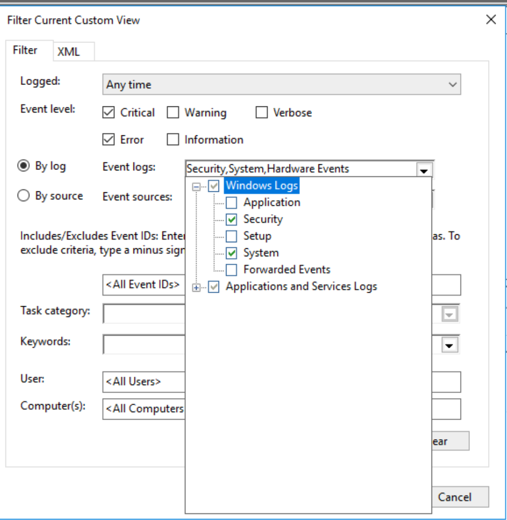

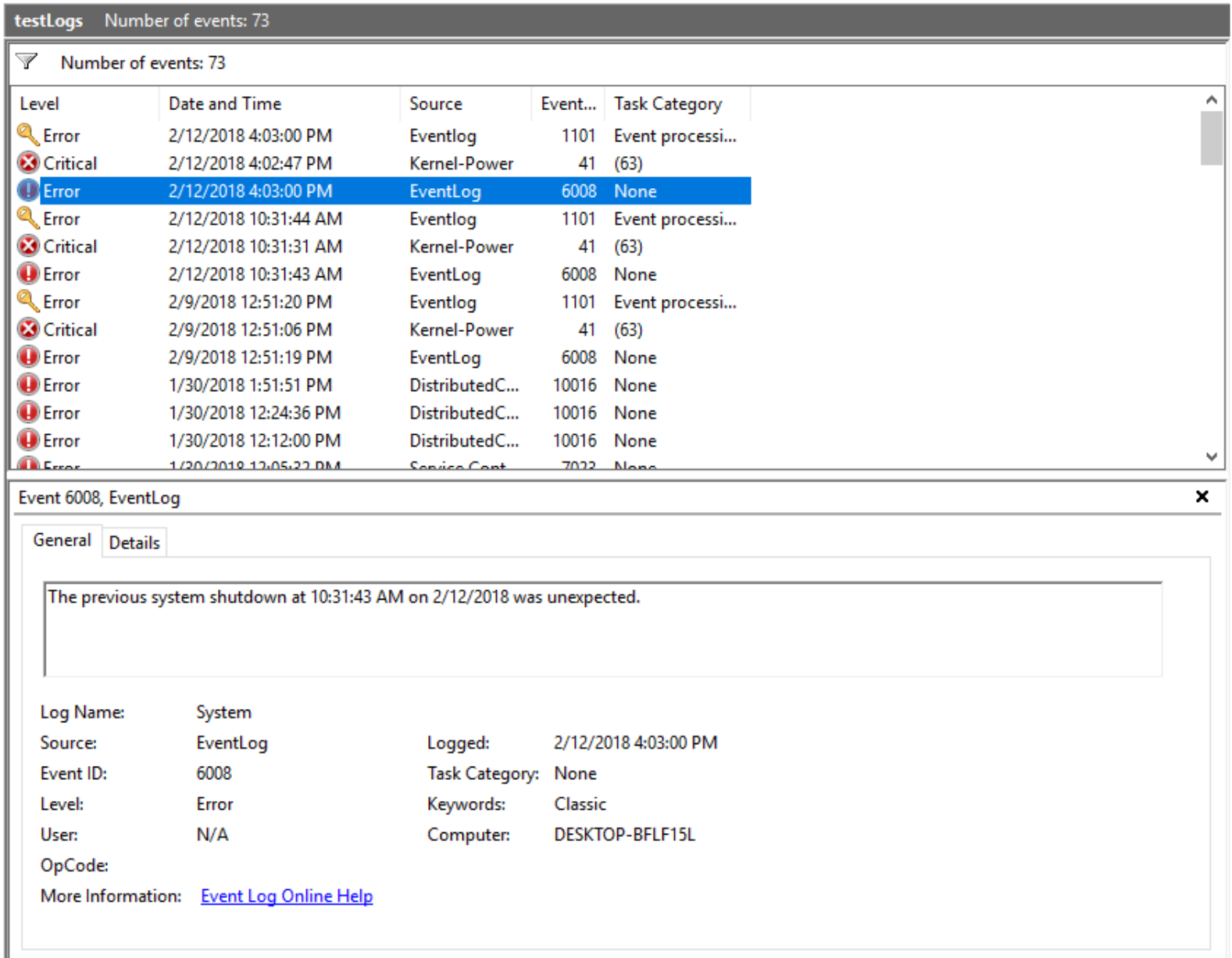

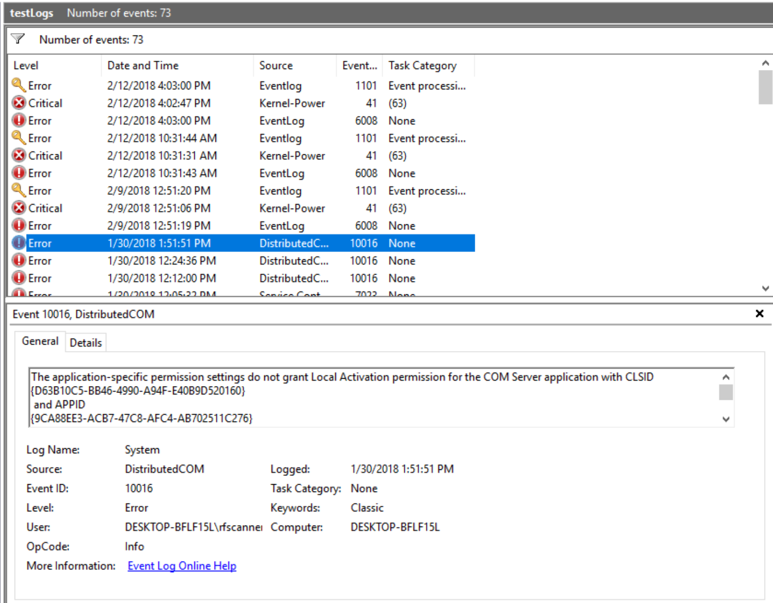

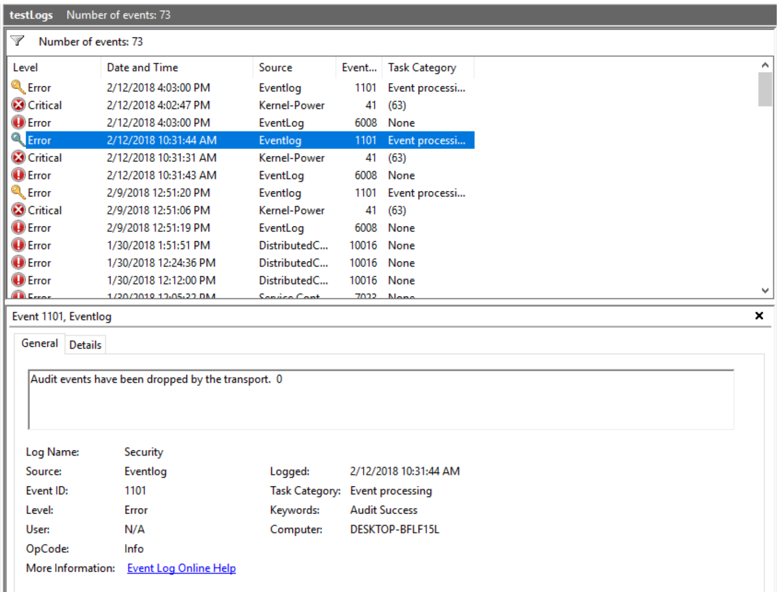

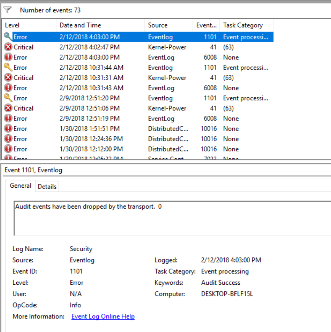

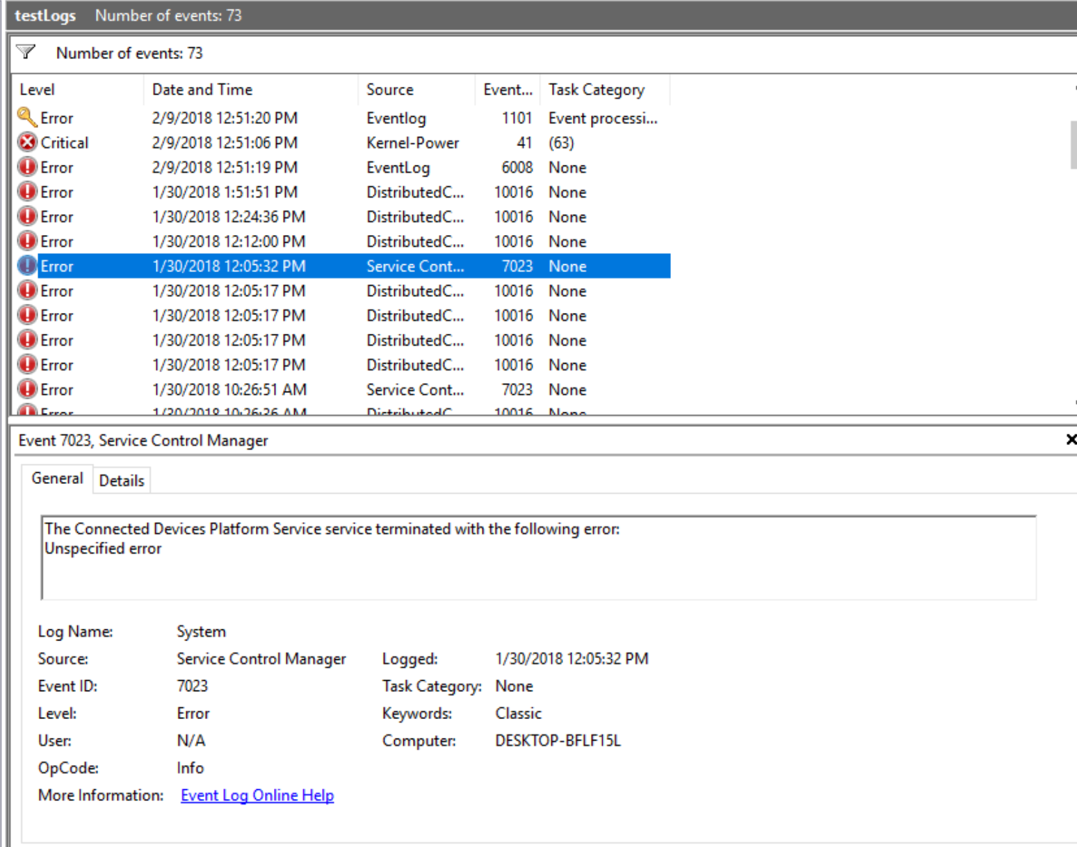

So I made a custom event log viewer, and I added screenshot of logs in attachment.
Thank you.
Filter of events
