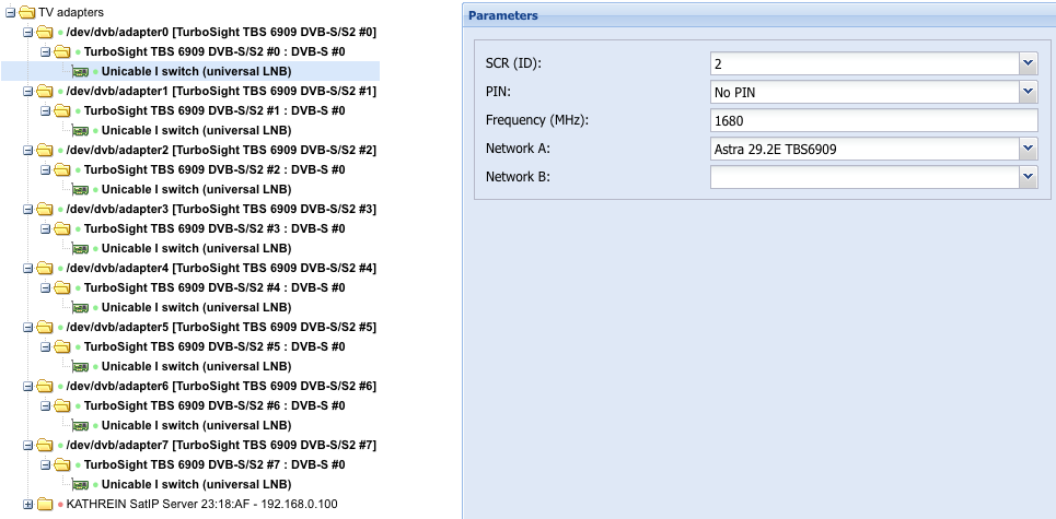

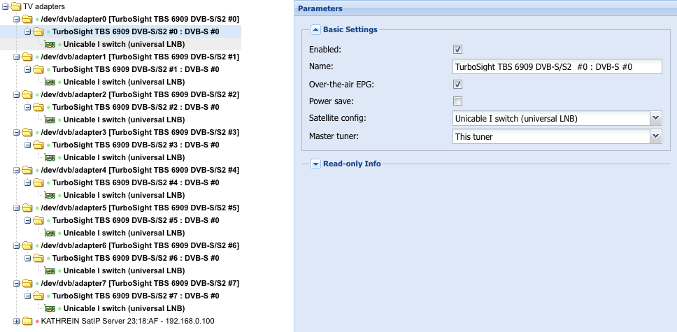

In my current situation I have at least two problems:
1.) When I watch a channel (TVHClient on iOS) and start streaming a different channel on another device the first one stops. The corresponding log entries are:
2019-11-18 17:05:21.790 [   INFO] subscription: 0015: "HTTP" subscribing on channel "Das Erste HD", weight: 100, adapter: "TurboSight TBS 6909 DVB-S/S2  #0 : DVB-S #0", network: "Astra 29.2E TBS6909", mux: "11493.75H", provider: "ARD", service: "Das Erste HD", profile="pass", hostname="192.168.0.214", client="TvhClient/883 LibVLC/3.0.7"
2019-11-18 17:05:28.028 [WARNING] linuxdvb: TurboSight TBS 6909 DVB-S/S2  #6 : DVB-S #0 - poll TIMEOUT
2019-11-18 17:05:28.838 [WARNING] linuxdvb: TurboSight TBS 6909 DVB-S/S2  #6 : DVB-S #0 - retune nodata
2019-11-18 17:05:33.626 [   INFO] subscription: 0015: "HTTP" unsubscribing from "Das Erste HD", hostname="192.168.0.214", client="TvhClient/883 LibVLC/3.0.7"
2019-11-18 17:05:35.688 [WARNING] linuxdvb: TurboSight TBS 6909 DVB-S/S2  #6 : DVB-S #0 - poll TIMEOUT
2019-11-18 17:05:35.960 [WARNING] linuxdvb: TurboSight TBS 6909 DVB-S/S2  #6 : DVB-S #0 - retune nodata
2019-11-18 17:05:43.348 [WARNING] linuxdvb: TurboSight TBS 6909 DVB-S/S2  #6 : DVB-S #0 - poll TIMEOUT
2019-11-18 17:05:44.308 [WARNING] linuxdvb: TurboSight TBS 6909 DVB-S/S2  #6 : DVB-S #0 - retune nodata
2019-11-18 17:05:51.008 [WARNING] linuxdvb: TurboSight TBS 6909 DVB-S/S2  #6 : DVB-S #0 - poll TIMEOUT
2019-11-18 17:05:51.554 [WARNING] linuxdvb: TurboSight TBS 6909 DVB-S/S2  #6 : DVB-S #0 - retune nodata
2019-11-18 17:05:55.757 [   INFO] mpegts: 11362H in Astra 29.2E TBS6909 - tuning on TurboSight TBS 6909 DVB-S/S2  #1 : DVB-S #0
2019-11-18 17:05:55.757 [   INFO] subscription: 000E: "epggrab" unsubscribing
2019-11-18 17:05:55.968 [   INFO] subscription: 0017: "HTTP" subscribing on channel "ZDF HD", weight: 100, adapter: "TurboSight TBS 6909 DVB-S/S2  #1 : DVB-S #0", network: "Astra 29.2E TBS6909", mux: "11362H", provider: "ZDFvision", service: "ZDF HD", profile="pass", hostname="192.168.0.214", client="TvhClient/883 LibVLC/3.0.7"
2019-11-18 17:05:57.621 [WARNING] tbl-base: pat: 11362H in Astra 29.2E TBS6909: TSID change detected - old 0401 (1025), new 03f3 (1011)
2019-11-18 17:05:58.668 [WARNING] linuxdvb: TurboSight TBS 6909 DVB-S/S2  #6 : DVB-S #0 - poll TIMEOUT
2019-11-18 17:05:59.054 [WARNING] linuxdvb: TurboSight TBS 6909 DVB-S/S2  #6 : DVB-S #0 - retune nodata
2019-11-18 17:06:06.328 [WARNING] linuxdvb: TurboSight TBS 6909 DVB-S/S2  #6 : DVB-S #0 - poll TIMEOUT
2019-11-18 17:06:06.359 [WARNING] linuxdvb: TurboSight TBS 6909 DVB-S/S2  #6 : DVB-S #0 - retune nodata
2019-11-18 17:06:06.968 [   INFO] mpegts: 11362H in Astra 29.2E TBS6909 scan complete
2019-11-18 17:06:07.266 [WARNING] tbl-base: pat: 11302.75H in Astra 29.2E TBS6909: TSID change detected - old 03fb (1019), new 03f3 (1011)
2019-11-18 17:06:07.267 [WARNING] tbl-base: pat: 11493.75H in Astra 29.2E TBS6909: TSID change detected - old 03fb (1019), new 03f3 (1011)
(Note: Several epggrabs are running at the same time).

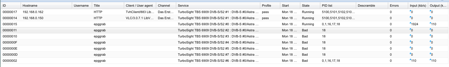

2.) When epggrab runs on all tuners, I get several "bad" states in status/subscriptions. In addition, the log shows:
2019-11-18 16:52:34.002 [WARNING] linuxdvb: TurboSight TBS 6909 DVB-S/S2  #1 : DVB-S #0 - retune nodata
2019-11-18 16:52:40.795 [WARNING] linuxdvb: TurboSight TBS 6909 DVB-S/S2  #1 : DVB-S #0 - poll TIMEOUT
2019-11-18 16:52:41.286 [WARNING] linuxdvb: TurboSight TBS 6909 DVB-S/S2  #1 : DVB-S #0 - retune nodata
2019-11-18 16:52:48.456 [WARNING] linuxdvb: TurboSight TBS 6909 DVB-S/S2  #1 : DVB-S #0 - poll TIMEOUT
2019-11-18 16:52:48.514 [WARNING] linuxdvb: TurboSight TBS 6909 DVB-S/S2  #1 : DVB-S #0 - retune nodata
2019-11-18 16:52:56.116 [WARNING] linuxdvb: TurboSight TBS 6909 DVB-S/S2  #1 : DVB-S #0 - poll TIMEOUT
2019-11-18 16:52:56.834 [WARNING] linuxdvb: TurboSight TBS 6909 DVB-S/S2  #1 : DVB-S #0 - retune nodata
I attached screenshots of the problems and my configuration.
