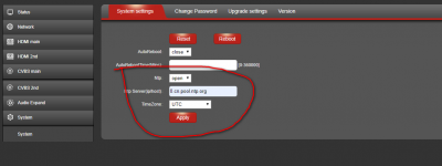

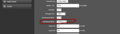

Postby echomay » Tue Sep 22, 2020 9:47 am
Please set the timestamp mode as "realtime". and open the ntp, choose "UTC".
