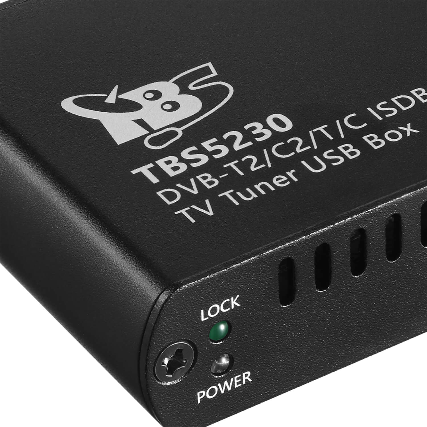

| DVB-T2 and T2-tdte |
Receiving channel: VHF band, UHF band |
| Bandwidth: 1.7, 5, 6, 7, 8MHz |
| FFT mode: 1K, 2K, 4K, 8K, 16K, 32K |
| 1/32, 1/16, 1/8, 1/4, 1/128, 19/128 and 19/256 guard intervals |
| 16, 32, 64, 128 and 256QAM modulations |
| Code rate: 1/2, 3/5, 2/3, 3/4, 4/5 and 5/6 |
| DVB-T |
6, 7 and 8MHz channel bandwidths |
| 2 and 8K FFT |
| QPSK, 16 and 64QAM |
| 1/2, 2/3, 3/4, 5/6 and 7/8 code rates |
| DVB-C2 |
6 and 8MHz channel bandwidths |
| 1/64 and 1/128 guard intervals |
| 16, 64, 256, 1024, 4096 QAM |
| 2/3, 3/4, 4/5, 5/6, 8/9 and 9/10 code rates |
| DVB-C |
1.7 to 7.2 Msym/s |
| 16, 32, 64, 128 and 256QAM |
| 0.15 roll-off factor |
| ISDB-T |
6, 7 and 8MHz bandwidth |
| 2, 4 and 8K FFT |
| 1/32, 1/16, 1/8 and 1/4 guard intervals |
| QPSK, 16QAM and 64QAM |
| ISDB-C |
5.274 Msym/s |
| 0.13 roll-off factor |
| 64 and 256QAM |
| TSMF (Transport Streams Multiplexing Frame) |
| J.83B (ITU-T J.83 v3.0 Annex B) |
5.056941, 5.360537, 5.6 Msym/s |
| 0.18 and 0.12 roll-off factor |
| 64 and 256QAM |
| ATSC1.0 |
6MHz channel bandwidths |
| 8VSB modulation |
| 2/3 code rate |
| Power consumption |
| Input/ Power: |
| temperature |
0 ~ 60℃ |
| System Requirements |
Windows XP / Vista/ 7/8/10, Linux |
| Digital TV signal DVB-T2/C2/T/C(J.83A/B/C),ISDB-T/C ,ATSC1.0. |
| Dimension: |
| TV tuner card size |
9 * 7.5 * 2.5(cm) |
| Net weight |
120g |
| Gift Box Size |
220 * 130 * 30mm |
| Weight |
350g |
| Package Contents |
1 x TBS5230 |
| 1 x USB cable |
| 1 x F-IEC |
