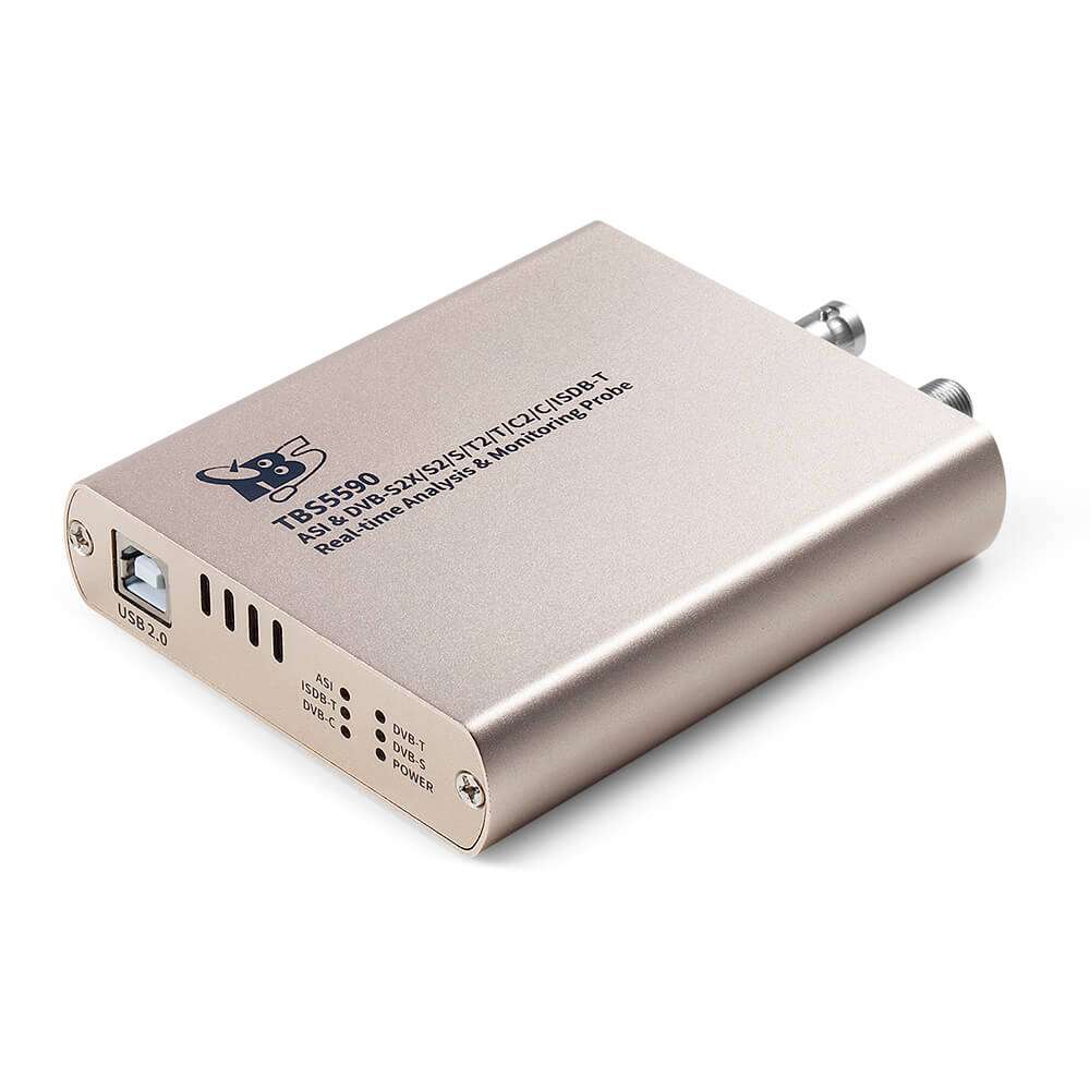

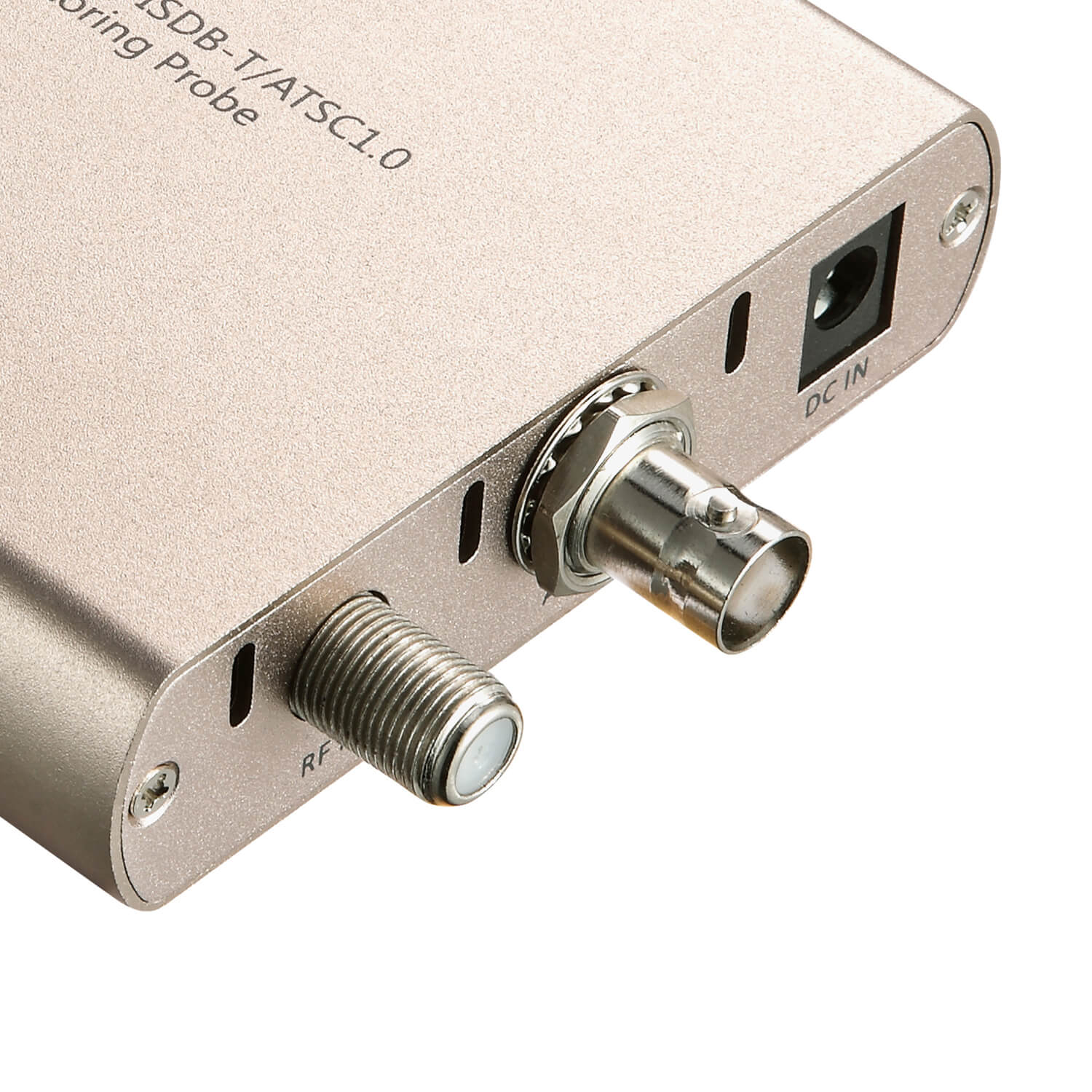

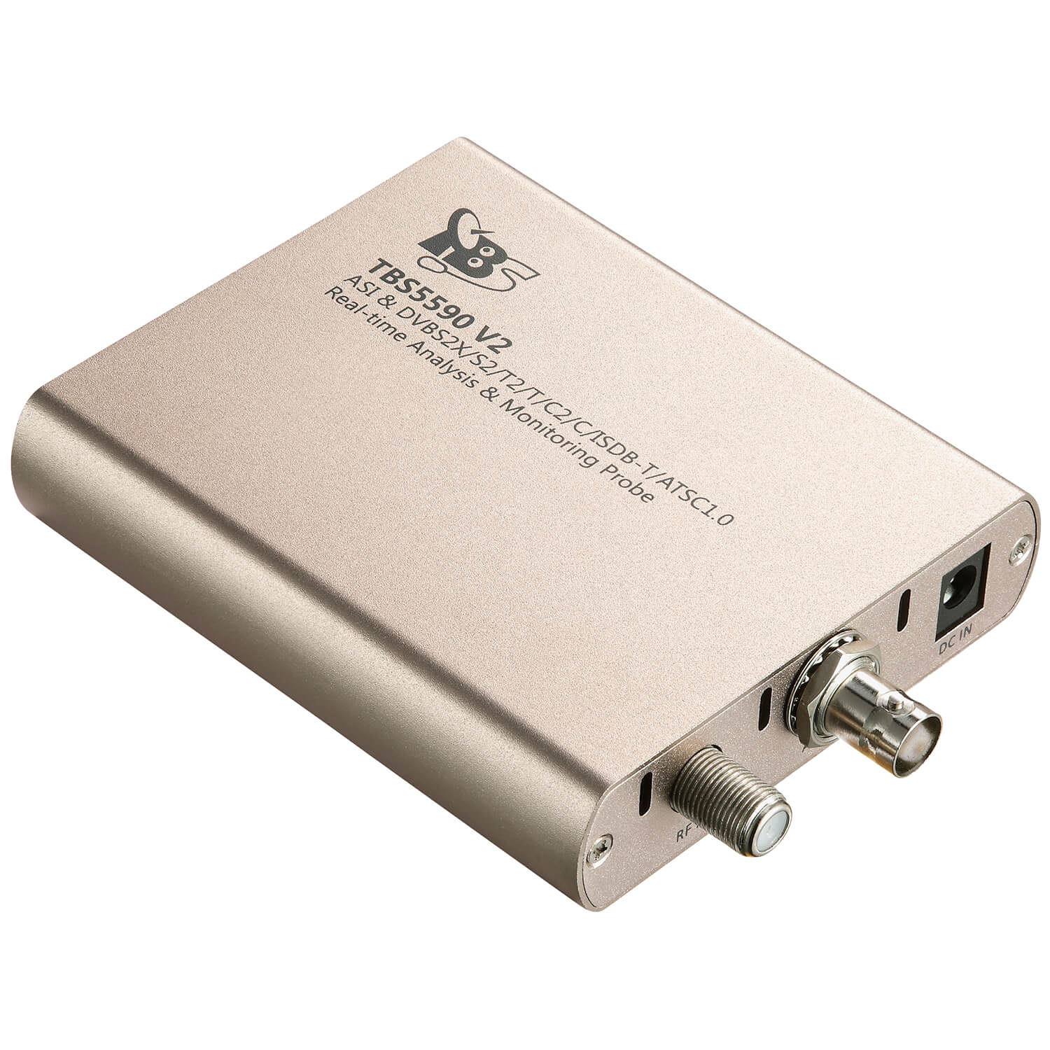

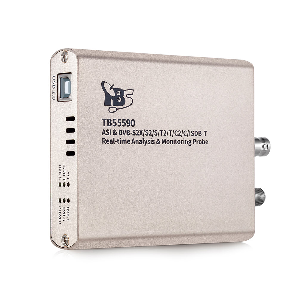

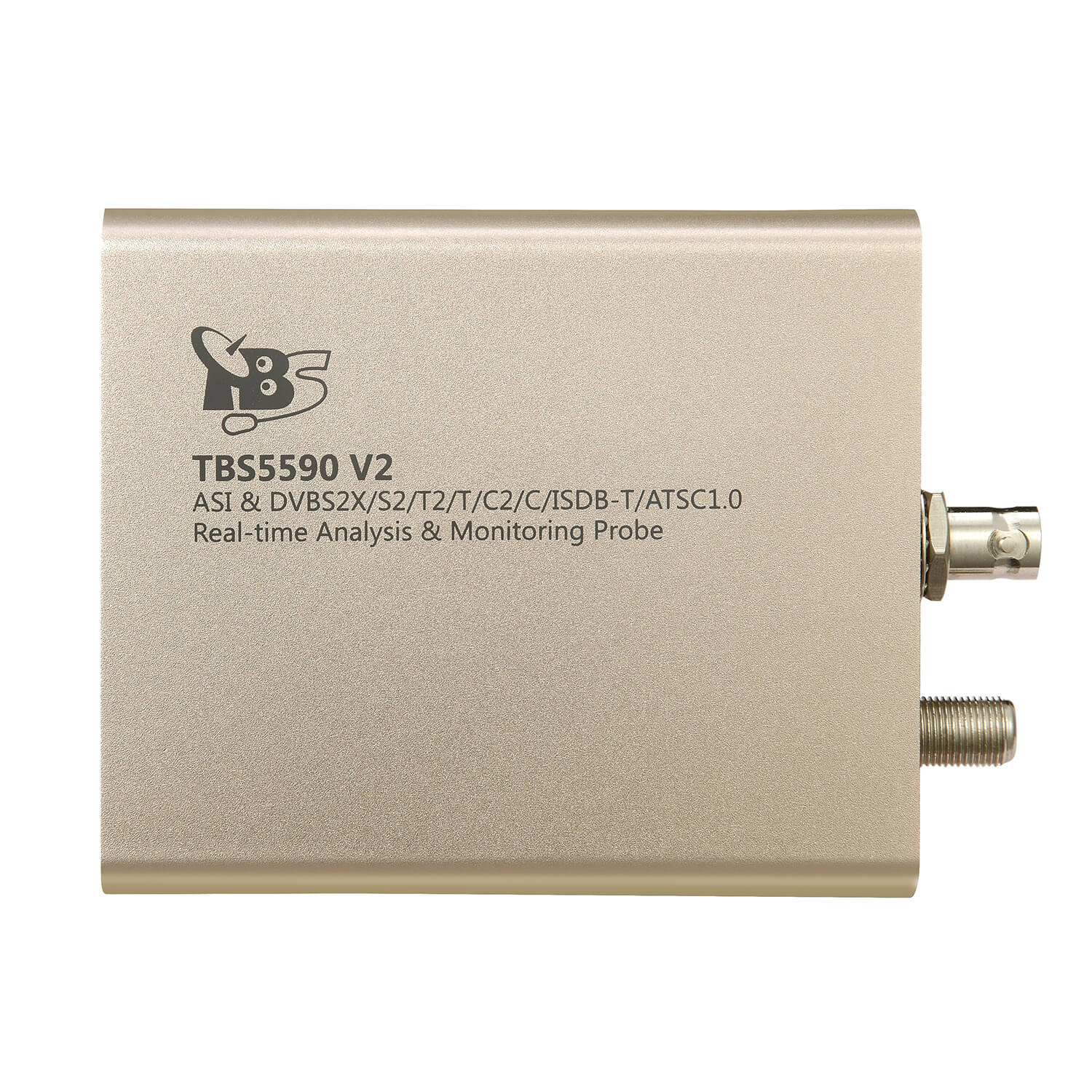

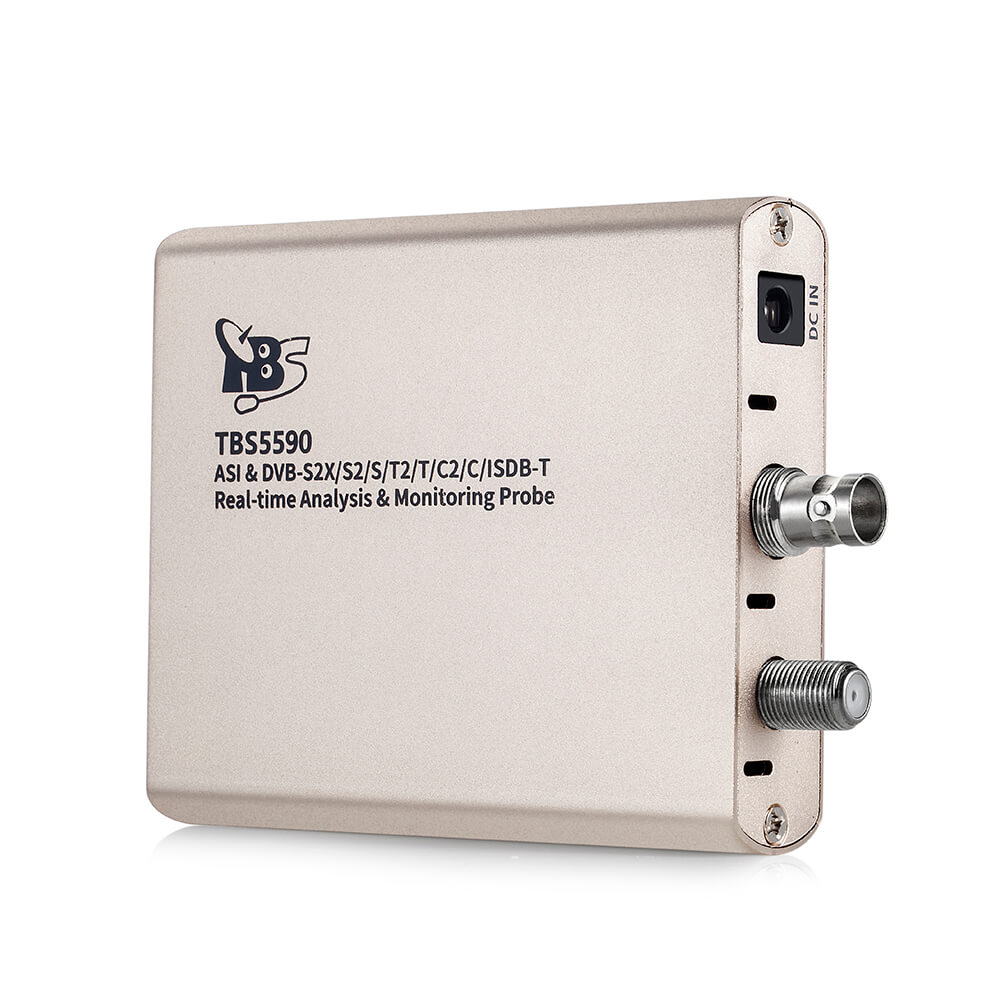

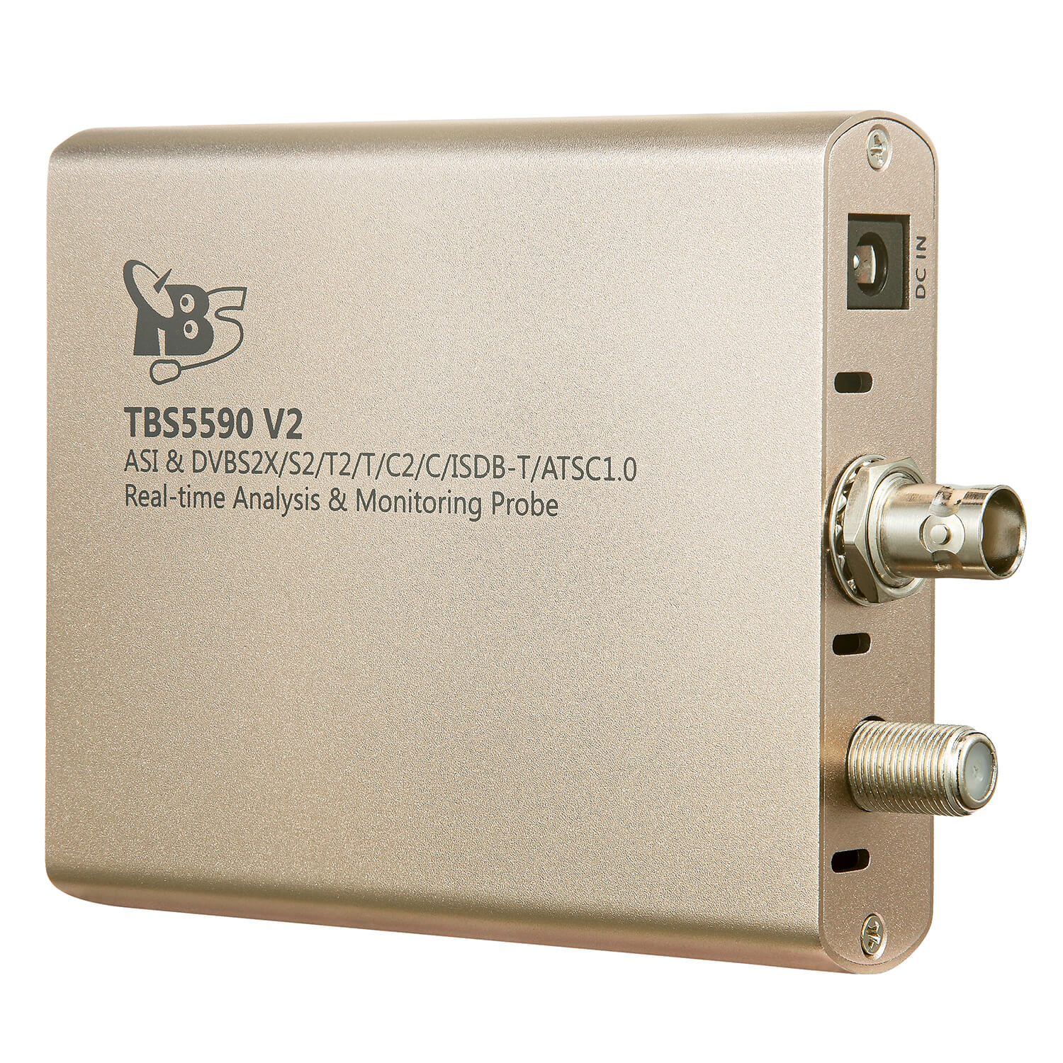

    TBS5590 V2 Multi-standard Real-time Analysis & Monitoring Probe
    TBS5590 V2 is a DVB multi-standard external TV tuner box with USB2.0 interface. It is capable of receiving digital TV channels of multiple standards: DVB-S2X/S2/S/T2/T/C2/C/ASI/ISDB-T. Through the USB interface, you can easily plug the TBS5590 V2 Universal TV Tuner box to your desktop or laptop PC for watching or recording different standards digital TV channels.

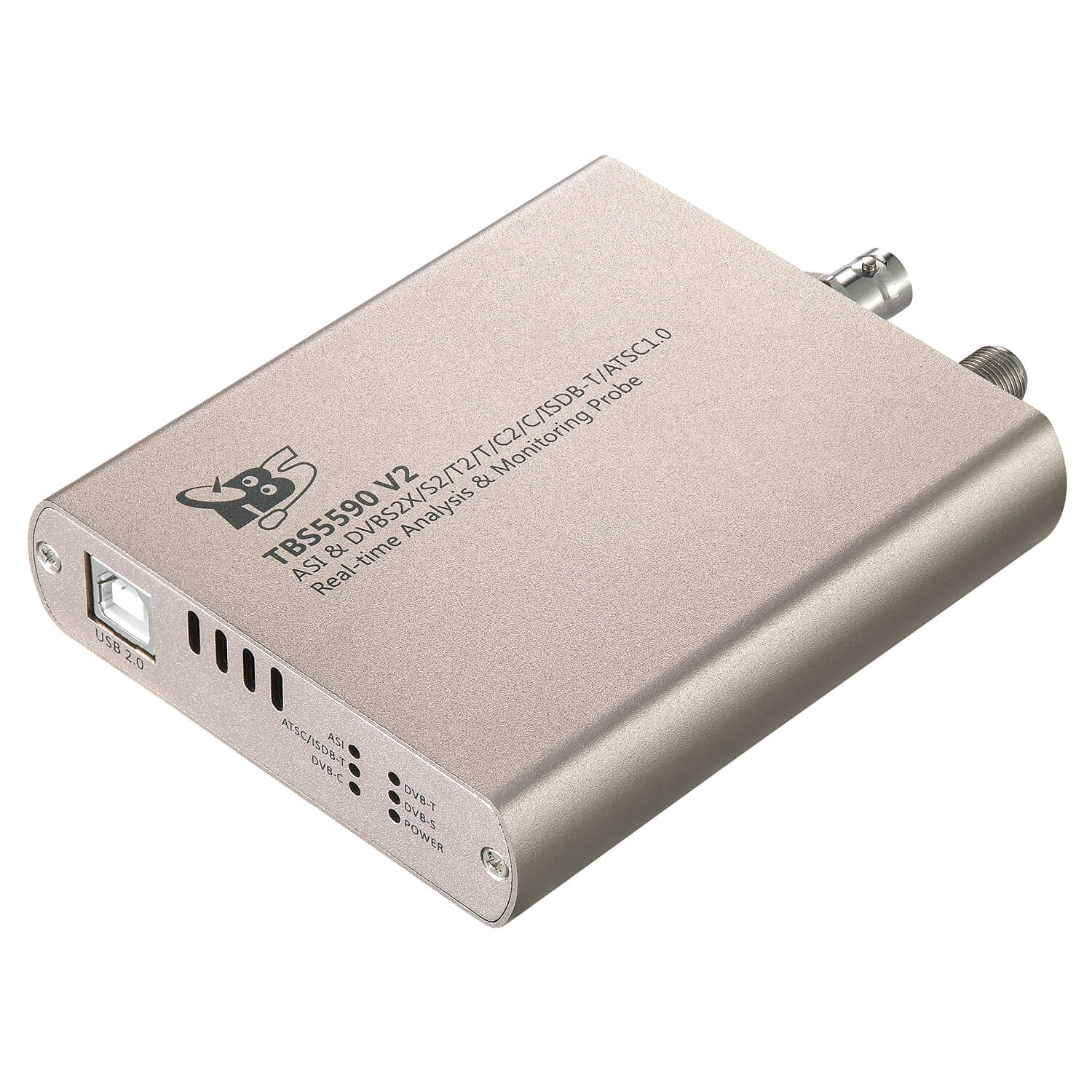

    TBS5590 V2 is a DVB multi-standard external TV tuner box with USB2.0 interface. It is capable of receiving digital TV channels of multiple standards: DVB-S2X/S2/S/T2/T/C2/C/ASI/ISDB-T/ATSC1.0

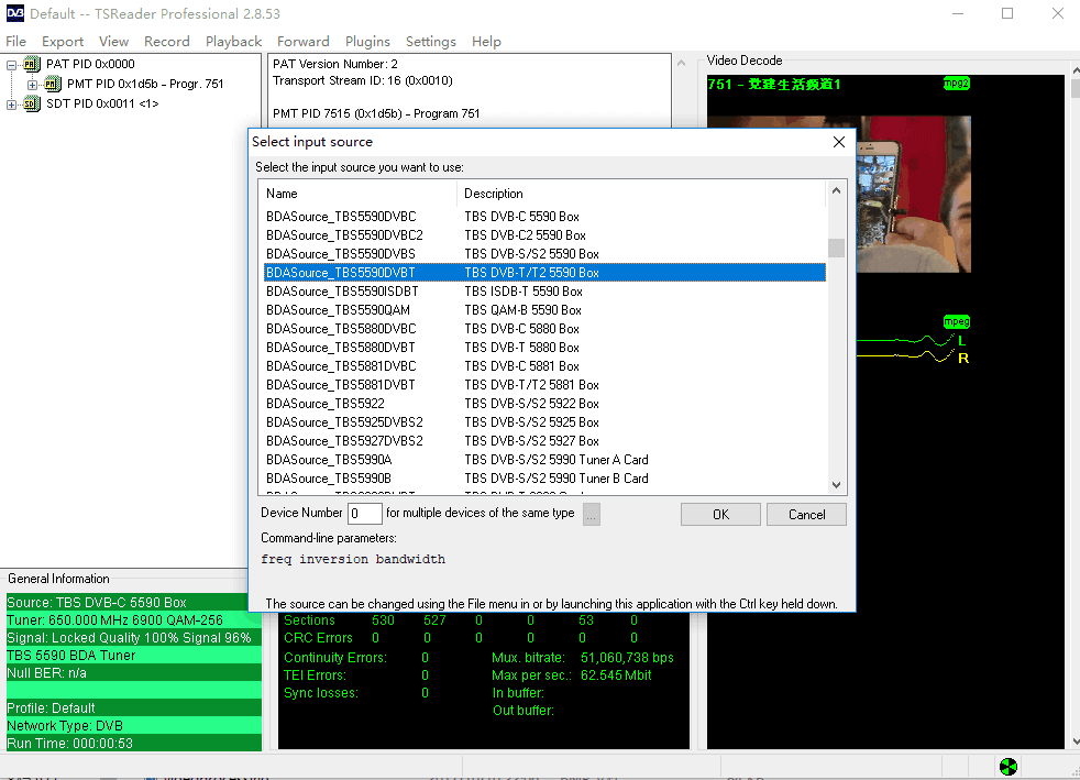

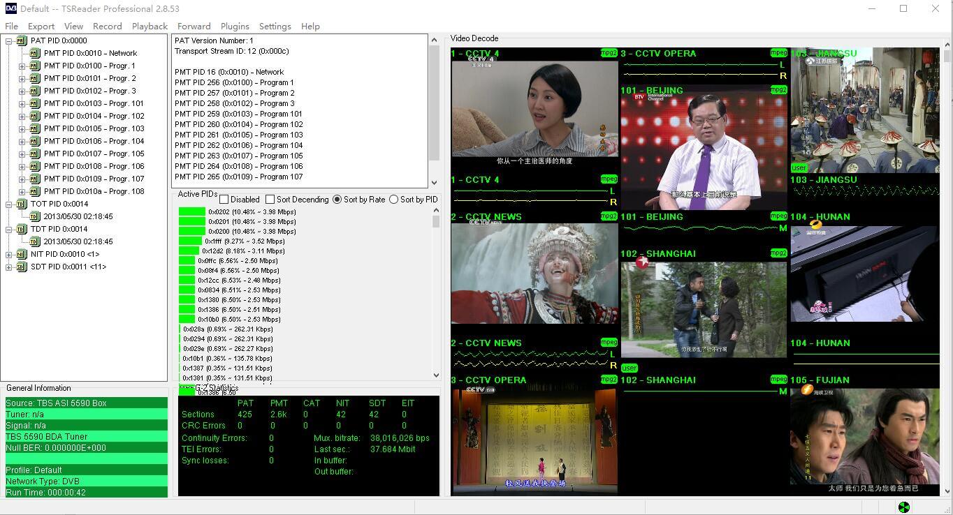

    Coupled with TSReader software, TBS5590 V2 is an ideal tool to do Real-time analysis, monitoring and recording of MPEG Transport Streams. TBS5590 V2 is supported in TSReader 2.8.53 and later version, which includes source modules for each mode and will automatically reprogram the demodulator when changing modes.

    • Support Real-time TV stream Analysis & Monitoring
    • Support Bitrate measurement
    • Support elementary stream information analyzing.
    Specification:
    Digital TV Standards:
    ISDBT COFDM demodulator and FEC decoding
    Support 3 layers decoding
    TMCC decoding
    Support differential demodulation
    AC1 and AC2 decoding
    DVBT2 and T2-Lite Receiving channel: VHF band, UHF band
    Bandwidth: 1.7, 5, 6, 7, 8MHz
    FEC: QPSK, 16QAM, 64QAM.256QAM
    Code rate: 1/2, 2/3, 3/4, 5/6, 7/8
    DVBC2 COFDM Demodulator(16_QAM to 4096_QAM)
    FEC(LDPC/BCH) decoder
    Bandwidth: 6MHz, 7MHz, 8MHz
    DVBC and ITU-T j.83ANNEX B QAM demodulator
    FEC decoder
    1 to 7.2MSymbol/s
    DVB-S/DVBS2/DVBS2X Symbol rates: 1-45Msps
    FEC:
        DVB-S/S2
    QPSK: 1/2, 3/5, 2/3, 3/4, 4/5, 5/6, 8/9, 9/10
    8PSK: 3/5, 2/3, 3/4, 5/6, 8/9, 9/10
    16APSK: 2/3, 3/4, 4/5, 5/6, 8/9, 9/10
    32APSK: 3/4, 4/5, 5/6, 8/9, 9/10
        DVB-S2x
    QPSK: 13/45, 9/20, 11/20
    2_4_2_APSK: 100/180, 104/180
    8PSK: 23/36, 25/36, 13/188_8_APSK: 90/180, 96/180, 100/180, 18/30, 20/30
    16APSK: 26/45, 3/5, 28/45, 23/36, 25/36, 13/18, 140/180, 154/180
    4_12_16rb_APSK: 2/3
    4_8_4_16_APSK: 128/180, 132/180, 140/180
    DVB-ASI Up to 120Mbps
    ATSC1.0 6MHz channel bandwidths
    8VSB modulation
    2/3 code rate
    Power consumption
    Input/power 12V/2A
    Temperature 0~60℃
    Available USB 2.0 slot
    Digital TV signal ISDB-T/DVB-T2/C2/S2X/S2/T/C/S, and DVB-ASI
    Dimension:
    TV tuner box size 103 * 88 * 22mm
    Net weight 260g
    Gift Box Size 210 * 174 * 55mm
    Gross Weight 800g

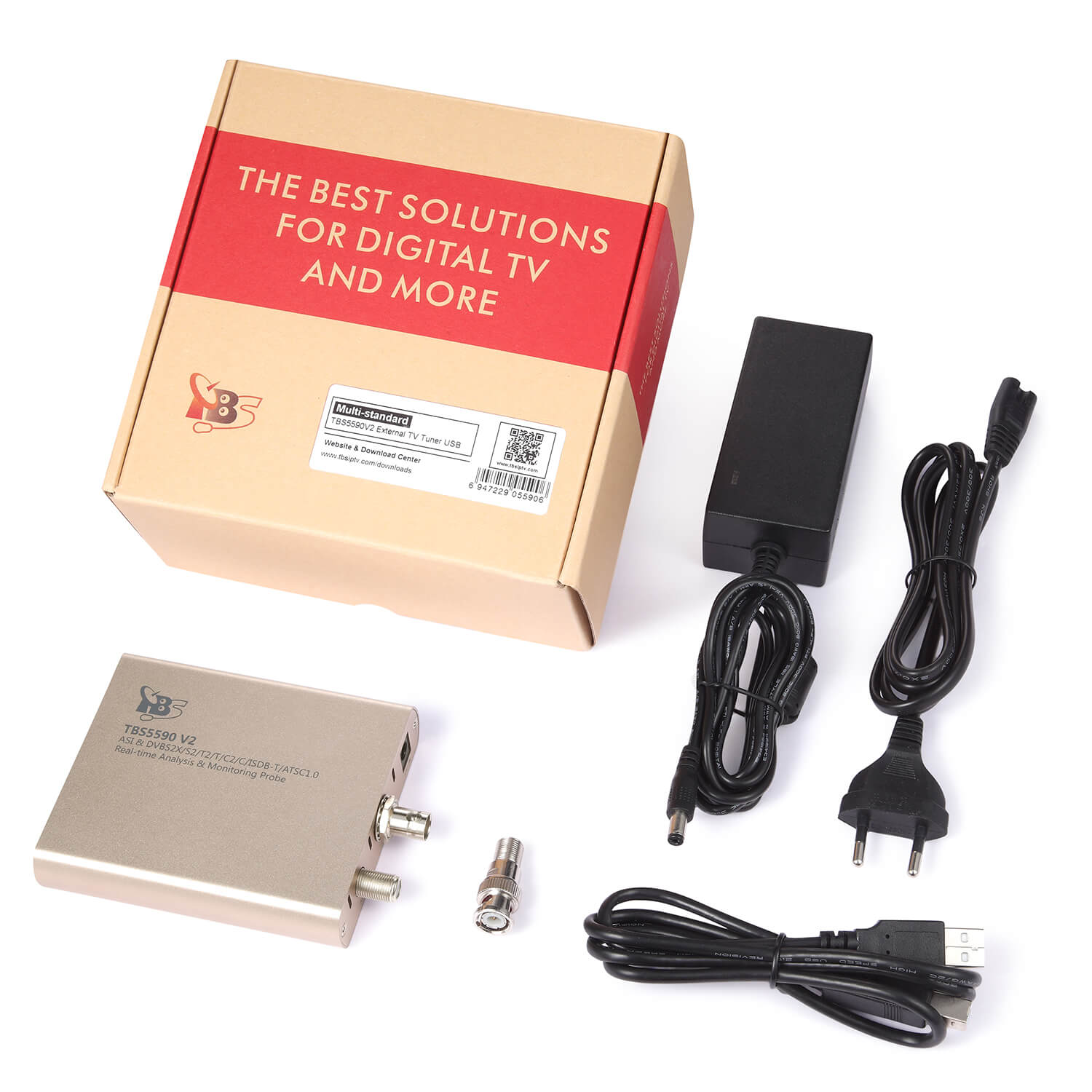

    Package Contents 1x TBS5590 V2
    1X USB Cable
    DC 12V Adapter
