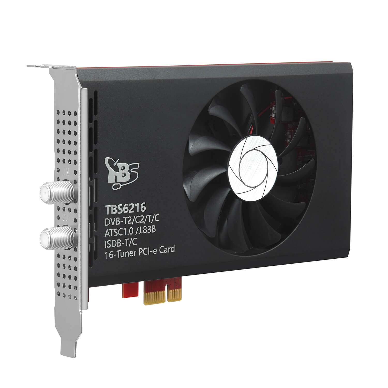

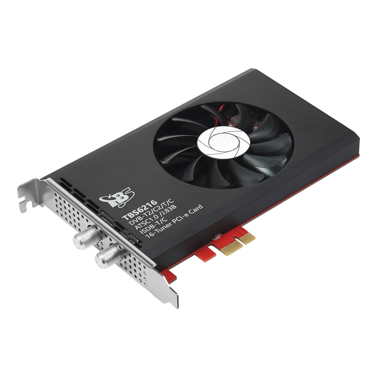

    TBS6216 is a 16-tuner TV card with a PCI-Express interface that supports a comprehensive range of broadcast standards, including DVB-T2/T, DVB-C2/C (J.83A/B/C), ISDB-T/C, and ATSC 1.0. It can lock up to 16 frequencies simultaneously, allowing you to watch all the programs on these frequencies or record them using the digital video recorder(DVR) function.
    Designed specifically for industrial-level users, the TBS6216 16-tuner card delivers significantly higher channel reception capacity compared to typical dual or quad tuner cards when server PCIe slots are limited, making it an ideal choice for broadcasting systems.
    • DVB-T2/C2/T/C (J.83A/B/C), ISDB-T/C, ATSC1.0. SD or HD TV receiving
    • Multi-channel receiving/recording/streaming from 16 tuners simultaneously.
    • HD video capture with real-time & scheduled recording
    • High sensitivity 16-Tuner for the best digital TV reception

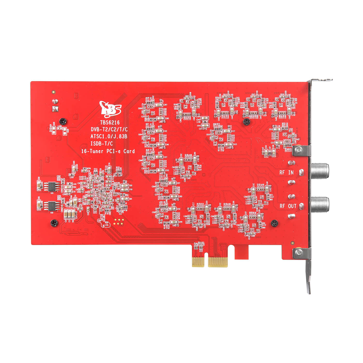

    Tuner Type 16 independent digital TV tuners
    Loop Out Support
