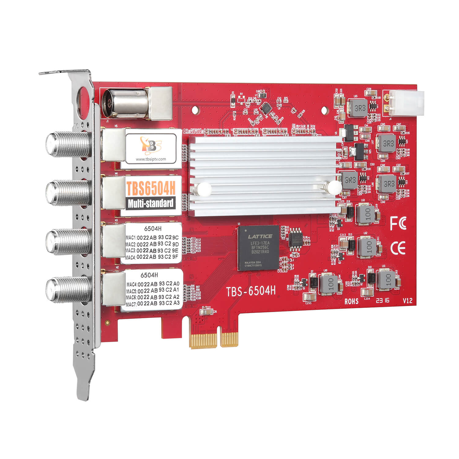

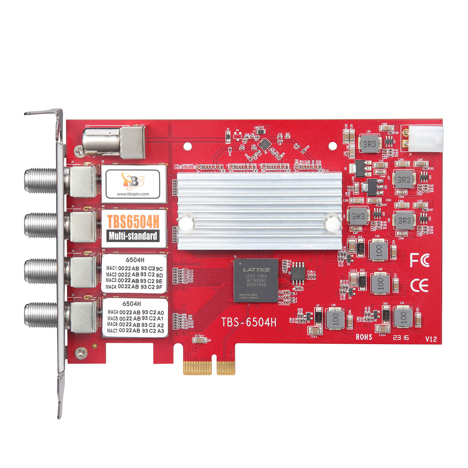

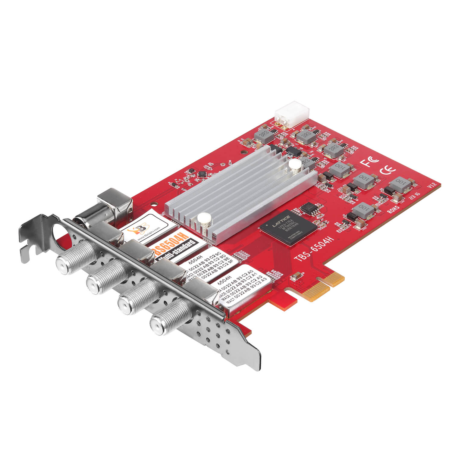

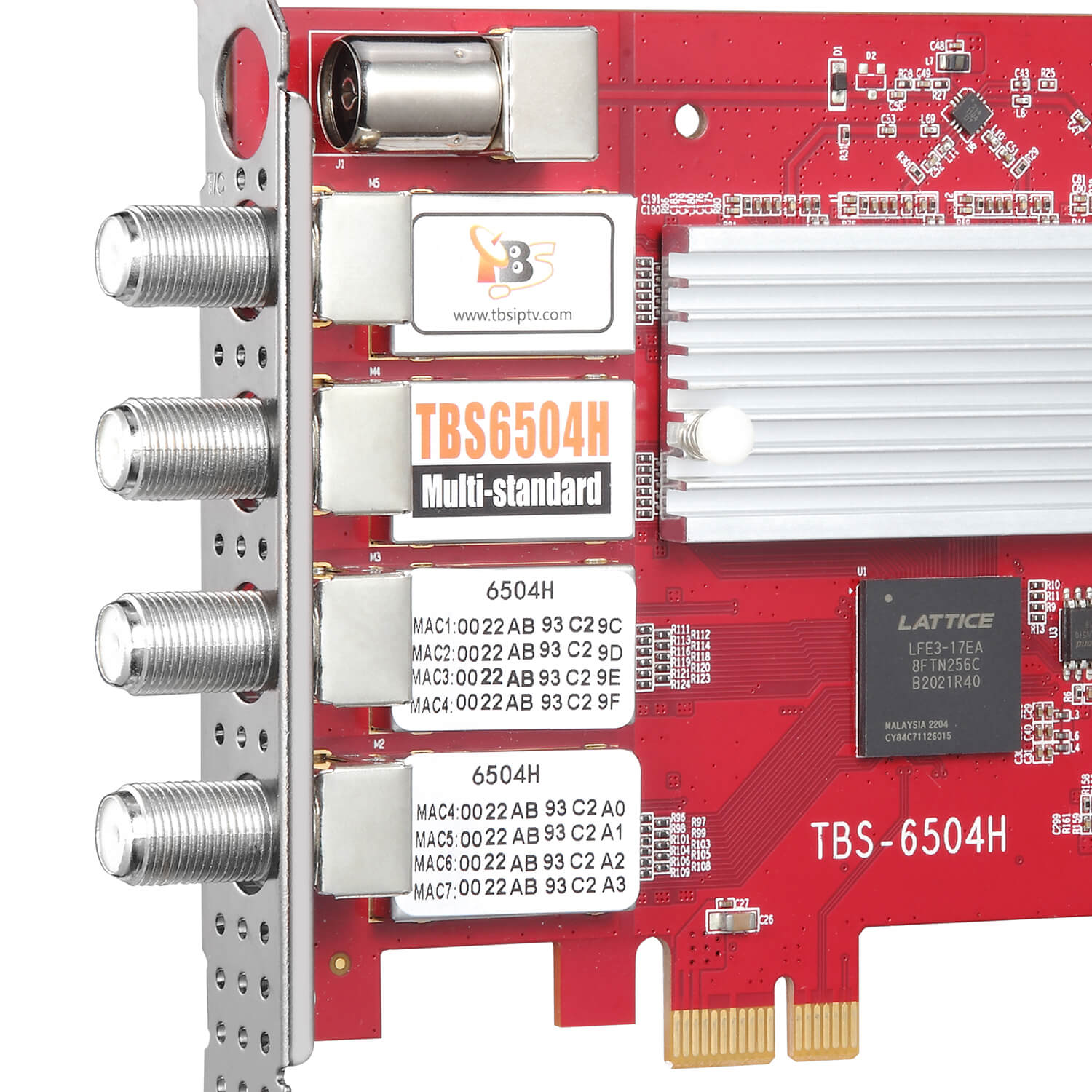

| Model |
TBS6504H |

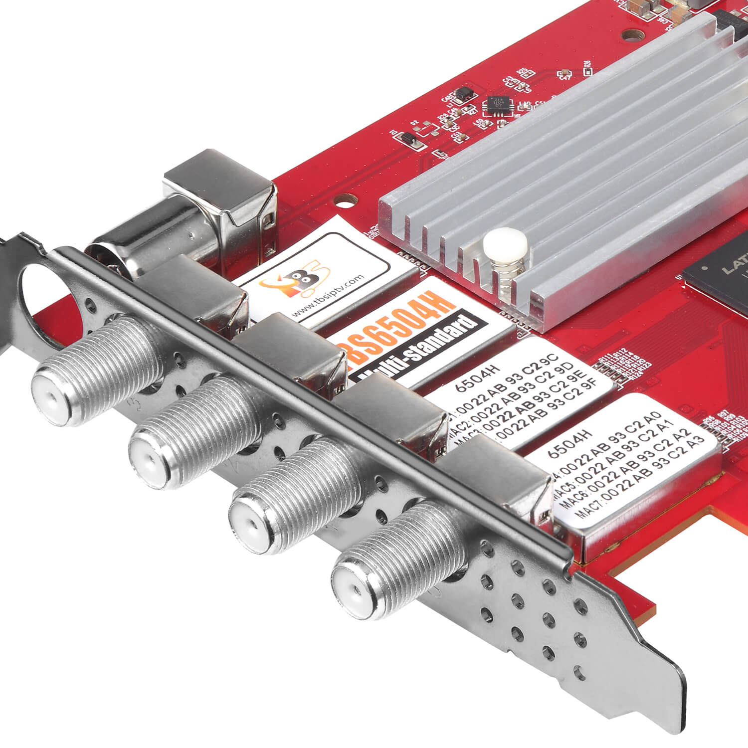

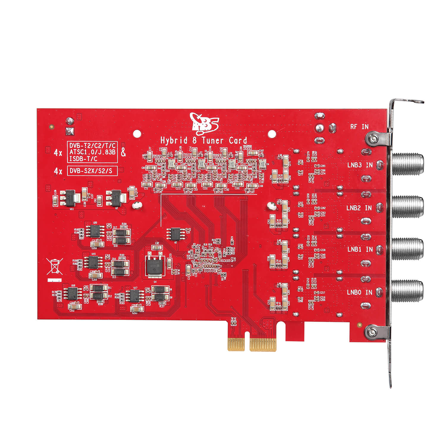

| Connector |
PCI-E |
8 x RF (4 satellite tuner + 4 Ter/Cable tuner) |

| Available PCI Express x1, x4, x8 or x16 slot |
| Digital TV signal (ISDB-T/DVB-T2/C2/S2X/S2/T/C/S) |
| TV tuner card size |
12.1cm * 10.8cm * 2cm |

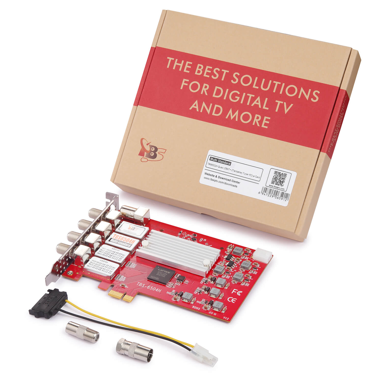

| Package Contents |
1 x TBS6504H |
| 1 x DC cable |
